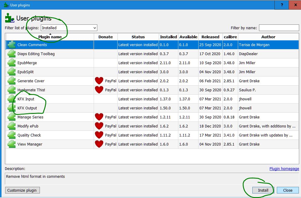

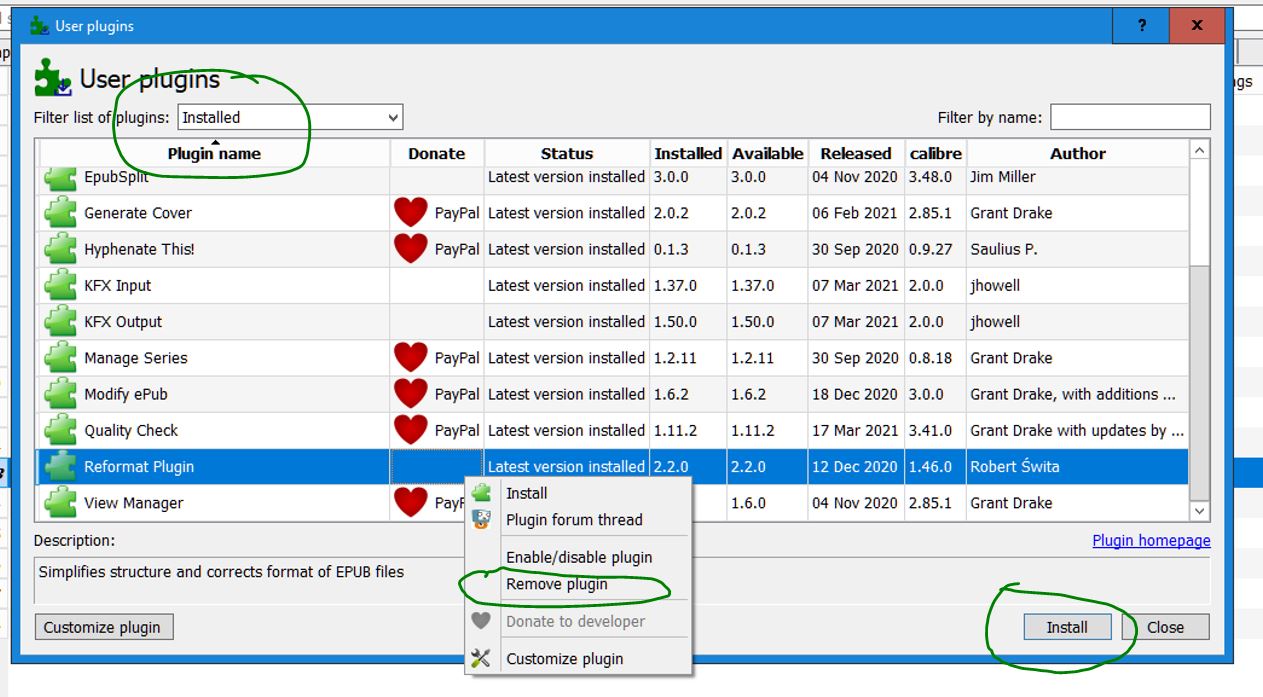

I wanted to uninstall a PI
Filtered by "Installed"
Highlighted the PI
The main button was still labeled [Install]
Finally figured the right-click and did what needed to be done
1. Changing the button caption depending on the action might eliminate some confusion. If an Installed PI is selected, then [Uninstall]. If an Uninstalled PI is selected, then [Install]
2. [Customize] is disabled (dim) when an uninstalled PI is selected (good), but is always enabled if an installed PI is selected, even though Calibre knows that there is no customization available. Maybe it should always be disabled unless there are customizations available

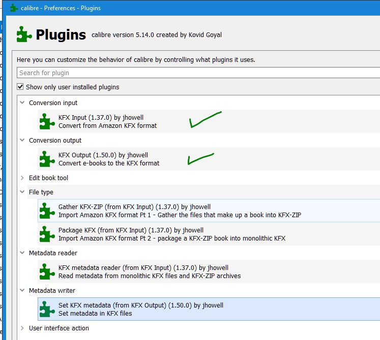

It appears that 'worker' PIs that are part of the main PI can be disabled. I don't know if that's a good thing. The KFX input and output PI each have helpers that can be individually disabled

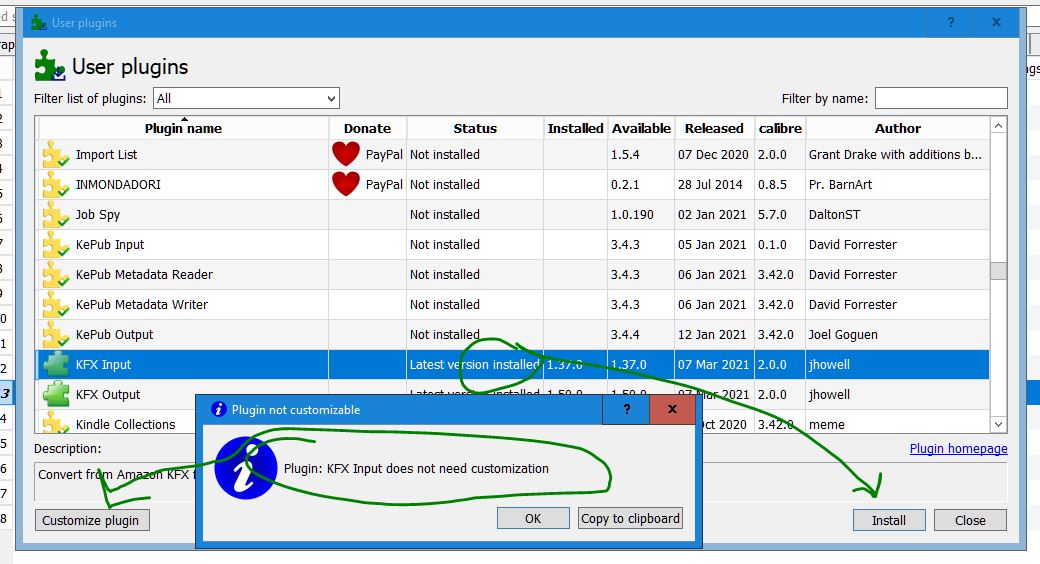

However, I still think that the UI for [Get Plugins to enhance calibre] should be internally consistent: [Uninstall] or [Install] as appropriate, [Customize] enabled if available

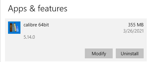

(FWIW In windows, you use the INSTALLER to remove a program)

However, [Preferences] shows all plugins, not just user ones (I saw the checkbox)
My comment was that using Preferences->Plugins certainly works, but since it apparently allows what I'm guessing is some sort of PI worker process to be uninstalled by itself, it doesn't seem as safe as using the [Get plugins to enhance calibre] option to uninstall a PI which seems to housekeep a PI and it's worker PIs all at one time.
Sorry, but, nothing along those lines happens with either method of removing a plugin. Both methods basically just delete the plugin file. They both just call the same method in the calibre base code to do this. There is no attempt to stop anything the plugin might have loaded, or to remove configuration or any other files the plugin created. Plugins do not have support for any uninstall actions. Both methods have lot more code than calling a method that deletes the zip file, but, it is all about updating the UI to show the plugin is no longer there.
As an example of this, the Annotations plugin starts something when calibre starts. And running calibre in debug mode, I can see a message that this is stopping when I close calibre. I just removed the plugin, waited a couple of minutes and closed calibre. Again, the Annotations thread wrote out a message about being closed. When I then installed the plugin, I didn't lose any configuration, and the button appeared in the same place in the toolbar.
From this, I think "remove" is the correct description of what is being done. If anything, "Install" is wrong and it should be "Add".

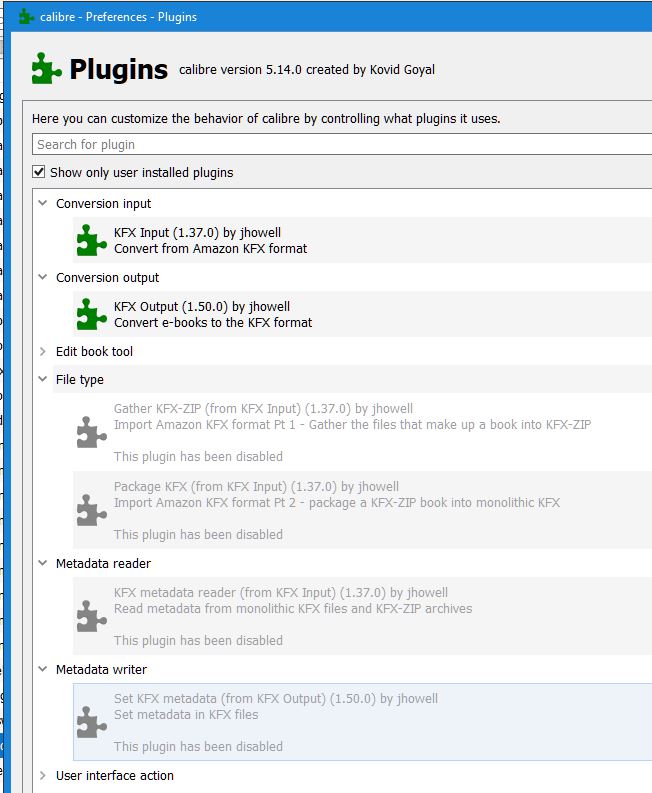

I probably used the wrong terminology, and I really didn't want to mess about too much by trying different things
I got as far as the attachment below, which looks like some components of the KFX PI's could be disabled. I was worried about the effect that might have on the main PI's
The gist of my first comment was that using the [Get plugins to enhance calibre] path, the button captions were (to me) a little misleading, in that an installed PI selected had a button captioned "Install" and that the Uninstall was on a right-click
