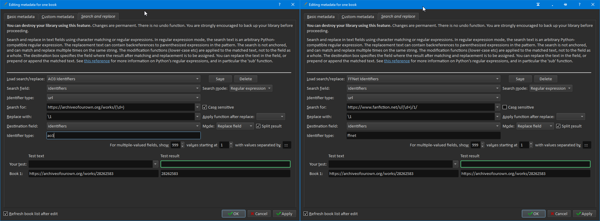

For fanfiction, I have custom ao3: and ffnet: identifiers that use the story ID. I use it for crossposted stories and because it looks a little nicer than the url: identifier in book details.
I have some search & replaces that extract the story ID from the urls and copy them to the identifiers, and then another that removes the URL identifiers. Here's the first two search & replaces (including what happens if you give the wrong url type to one):

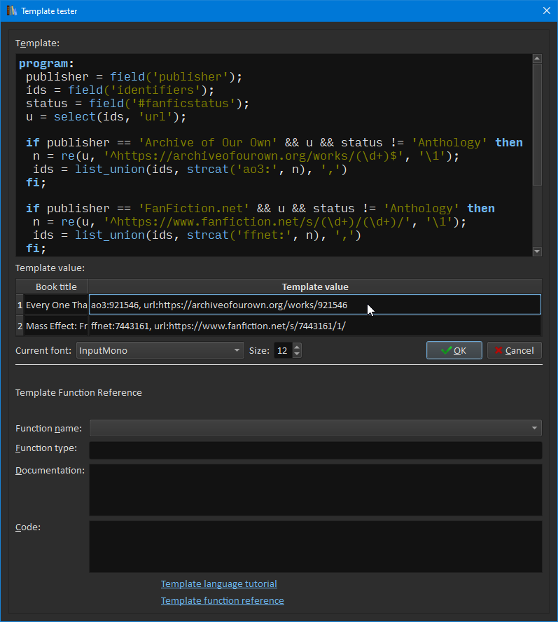

Ok I did some more tinkering of the code on #7 and tweaked the regexes a bit (^.*/(\d+)$ occasionally captured chapter numbers instead of the story id).
program:
	publisher = field('publisher');
	ids = field('identifiers');
	status = field('#fanficstatus');
	u = select(ids, 'url');
	if publisher == 'Archive of Our Own' && u && status != 'Anthology' then
		ids = list_difference(ids, strcat('url:', u), ',');
		n = re(u, '^https://archiveofourown.org/works/(\d+)', '\1');
		ids = list_union(ids, strcat('ao3:', n), ',')
	fi;
	if publisher == 'FanFiction.net' && u && status != 'Anthology' then
		n = re(u, '^https://www.fanfiction.net/s/(\d+)/(\d+)/', '\1');
		ids = list_union(ids, strcat('ffnet:', n), ',')
	fi;
	if 'Completed|Oneshot|Abandoned' in status && u &&
		(select(ids, 'ao3') || select(ids, 'ffnet')) then
	fi;
	ids
Oddly enough if I remove the last part it still removes the url: identifier
I will keep tinkering.
EDIT: If I remove the list_difference lines (except the last one), it does not remove url: Is that necessary for something else to work? I did not see any strange results when I tried with multiple books of different statuses
Name:	2021-03-26 05_14_57-Template tester.png

OK, I did some more testing of the code in #7. For some reason it behaves differently for Archive of Our Own and Fanfiction.net.
I am not sure of the transformation rules you want.
Here are transforms implemented by the template in #7
  • Case 1: Book with metadata
    • Publisher: Archive of Our Own
    • Status: In-Progress
    • ids: url:https://archiveofourown/works/12345
    then the template does:
    1. The first 'if' succeeds and
      • adds ao3:12345 to ids
      • removes url:... from ids
      The identifiers are now 'ao3:12345'
    2. The second 'if' condition fails because In-Progress is not in status.
    The result identifiers are 'ao3:12345'. This is wrong? Perhaps the first 'if' is not supposed to remove the url:... identifier?
  • Case 2: If the book has the following metadata:
    • Publisher: FanFiction
    • ids: ffnet:abcde, url:https://archiveofourown/works/9876
    1. The first 'if' condition fails because of wrong publisher, doing nothing
    2. The second 'if' condition fails because status is In-Progress, doing nothing.
    The ids remain 'ffnet:abcde, url:https://archiveofourown/works/9876'. Is this right?
  • Case 3: If the book has the following metadata:
    • Status: Completed
    2. The second 'if' condition succeeds because status is Completed. The url:... id is removed.
    The ids become 'ffnet:abcde'. Is this right?
You also must be careful about the order of evaluation. The second 'if' condition might succeed because the first 'if' adds the identifier 'ao3'. You may or may not always want that.
Old 03-26-2021, 05:11 AM   #11
chaley
Posts: 12,529
Karma: 8075744
Location: Notts, England
The list_difference() functions in the first 2 if blocks are removing identifiers. It seems that isn't what you want.

Yes, I only wanted to remove identifiers if they matched certain statuses. That's what the third part does. Thank you.
