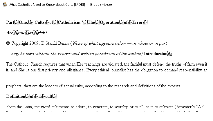

Anyway -- on straight conversion - several "paragraph" or "section" headers in PDF get converted with the text squashed together without spaces.
Meaning in pdf file you would see "first second third" but after conversion to MOBI you get "firstsecondthird"
I tried doing "search & replace" in conversion - to no avail -- in my test (screen prints attached) you can see i tried replacing "newline" with a string of letter "j"s -- which didnt happen.
ID:	185684   Click image for larger version
