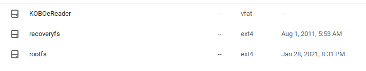

Old 02-12-2021, 01:34 PM   #4
Elektron
Banned
Elektron ought to be getting tired of karma fortunes by now.Elektron ought to be getting tired of karma fortunes by now.Elektron ought to be getting tired of karma fortunes by now.Elektron ought to be getting tired of karma fortunes by now.Elektron ought to be getting tired of karma fortunes by now.Elektron ought to be getting tired of karma fortunes by now.Elektron ought to be getting tired of karma fortunes by now.Elektron ought to be getting tired of karma fortunes by now.Elektron ought to be getting tired of karma fortunes by now.Elektron ought to be getting tired of karma fortunes by now.Elektron ought to be getting tired of karma fortunes by now.
Posts: 2,296
Karma: 5300240
Join Date: Jun 2020
Location: Edmonton, AB
Device: Kobo Aura H2O Edition 2 (mark 7), Kobo Mini
The SD looks like this right now.
Name:	Screenshot 2021-02-12 at 10.34.11 AM.png
Elektron is offline   Reply With Quote

Old 02-12-2021, 01:48 PM   #6
NiMa
NiMa ought to be getting tired of karma fortunes by now.NiMa ought to be getting tired of karma fortunes by now.NiMa ought to be getting tired of karma fortunes by now.NiMa ought to be getting tired of karma fortunes by now.NiMa ought to be getting tired of karma fortunes by now.NiMa ought to be getting tired of karma fortunes by now.NiMa ought to be getting tired of karma fortunes by now.NiMa ought to be getting tired of karma fortunes by now.NiMa ought to be getting tired of karma fortunes by now.NiMa ought to be getting tired of karma fortunes by now.NiMa ought to be getting tired of karma fortunes by now.
NiMa's Avatar
Posts: 507
Karma: 2390534
Join Date: Jun 2020
Location: Somewhere in the Universe
Device: Kobo Libra, Glo HD, Touch C/B, Mini, Glo, Aura SE, Clara HD, KT
What does a
df -h
outputs on your Kobo?
NiMa is offline   Reply With Quote

Originally Posted by NiMa View Post
What does a
df -h
I don't have vlasovsoft konsole or WiFi to SSH/telnet to my Kobo right now.

Originally Posted by Mercador View Post
Does the Mini accepts better than Fat16?
yep, the onboard partition is formatted in FAT32 IIRC
@Elektron: do it when you can, it would be very helpful. I think you were on a Chromebook seeing the screenshots, can you access a Linux shell while the SD is in? (CTRL+ALT+T in Chrome and then type "shell". You should be able to run df -h there...)
Check how the 4GB card is formatted and make sure the 16GB card is formatted the same.
