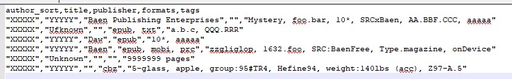

I really don't see why you want to use SQL unless simply as a learning experience. A CSV catalog gives you the same information, except the path, with no hassle at all. Example attached.
