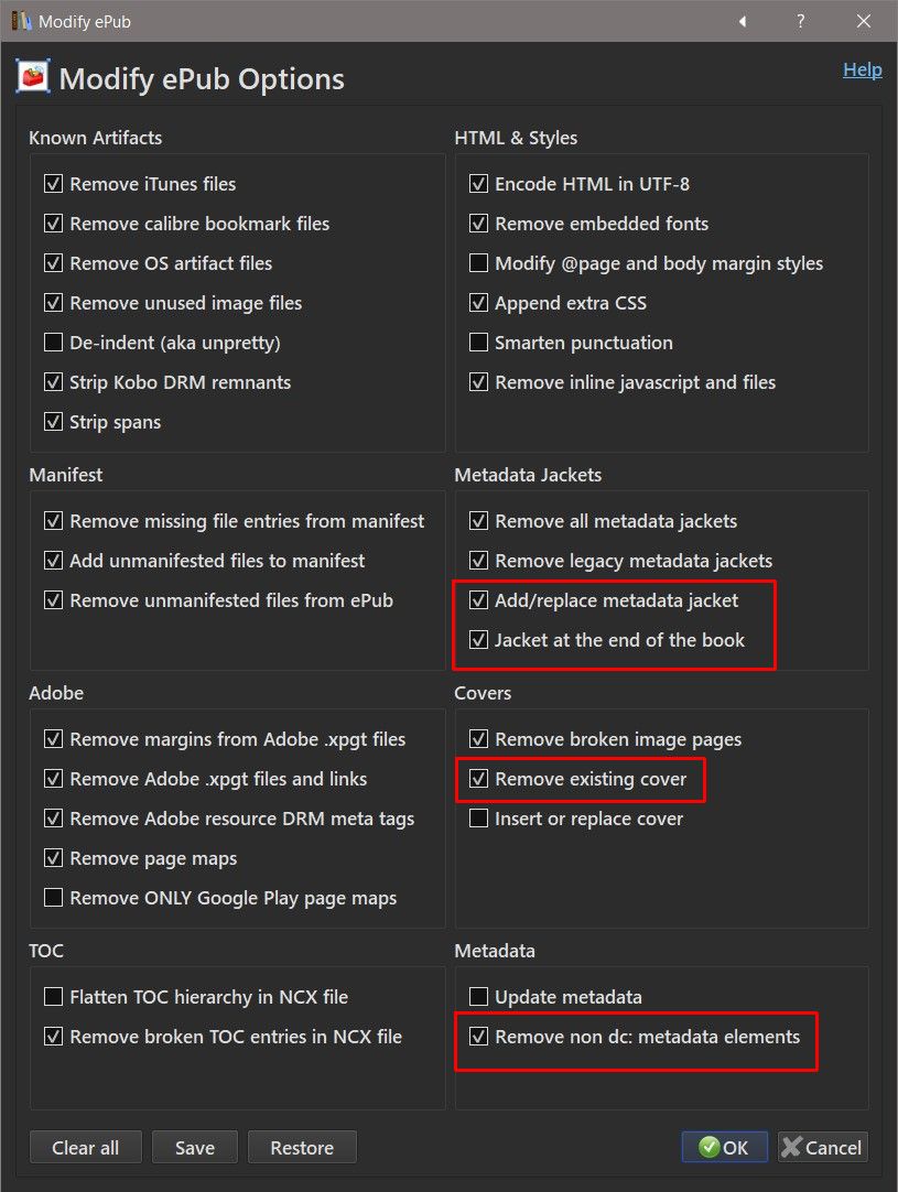

@lizzielou - FWIW: after converting a DOCX to EPUB, I use the Modify EPUB plugin to remove the generated cover from the EPUB. At the same time I also remove the embedded non Dublin Core metadata and insert a 'jacket' at the back of the book.

These are the Modify EPUB settings I use to: Add a jacket at the Back of the book; Remove the cover; and strip non Dublin Core metadata elements.
Name:	Screenshot 2022-04-19 081759.jpg
The other settings reflect my minimalist ways, which also led me to remove all the decorative elements from the book-jacket template.
