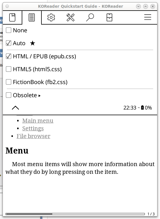

It is a buzzword, Jon. Each engine has their own set of rules to render html. Here's chromium's html.css. The fact that your desired epub file doesn't override most of them doesn't mean they're not applied.
Before reporting "rendering differences" between engines you should check that the "root" rules are equal. For instance KOReader uses epub.css for lean & mean epub files and html5.css for generic web-like stuff.
Claiming that CREngine doesn't support a given tag just because it is applying "epub.css" rules don't help. Of course your book might override some rules but knowing how CSS inheritance works is helpful.
I'm not aware how to change Coolreader rules (or if it's possible at all). On KOReader you can set them on document styles (see attachment). Users are suggested to apply what about if html5.css before reporting issues.
