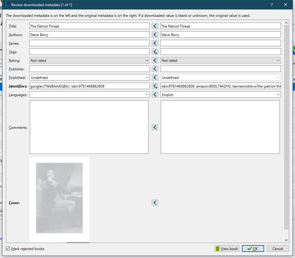

HOWEVER, I am finding that the "download metadata" feature (available when right-click on multiple ePubs that are missing metadata) does not seem to work under V5.x. I can see the metadata when looking at "view log" but when I look at "review downloaded metadata" none of the information is shown and no update is made to the displayed metadata (i.e. comments, ratings, tags, published date, etc).

Below I've copied the metadata download log for Steve Berry and you can see it is picking up comments, tags, published date. I don't know how to insert an image of the "review downloaded metadata" display but the fields for tags, comments, etc are simply blank and no metadata is updated (under Calibre V5,x ... but shows contents and updates okay if run under Calbre 4.x).

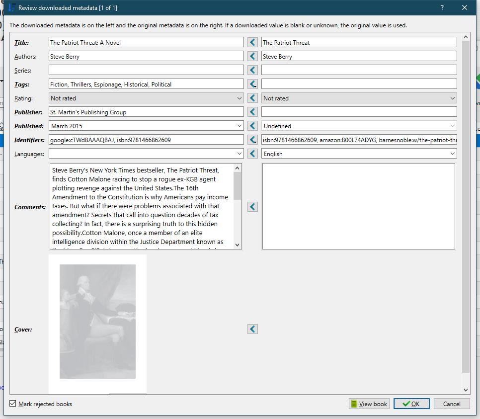

When I add the Steve Berry book with the identifiers in the log, and enabled just the Google and Amazon source enabled, I get:
Which is what I expect.
When I go to the metadata download options and unselect all the fields, I get:
Which sounds like what you are describing. So, check the configuration. You can do this before starting the metadata download by pressing the "Configure download" button. Make sure some fields are selected in both the main section and for the sources you use and try again.
