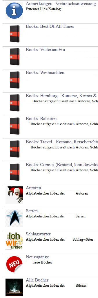

Well, try to understand - to make more clear what my intention is I add a pic of the result, wanted..
For the time being I always have to replace the icons after a new catalogue has been created

Solution:
To make use of my own icons they have to be added/replace the ones that are part of calibre2opds each time a new catalog has been created
