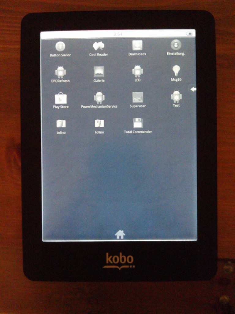

My googling produced an interesting find yesterday:
http://naberius.de/category/linux/programming/kernel/
Hecke has torn down a 99 euro Android reader from Germany called the Tolino Shine. Investigation of his pictures revealed that the hardware is very similar to the Glo. Not just the same parts, but the reference designators on the PWB are identical to my Glo.
Hecke was kind enough to post an image of the microsd in his Shine. I installed it in my Glo and it seems to work perfectly. It would be even better if I could read German
[Image violates Posting Guidelines for size - MODERATOR]
The frontlight button on the Glo is mapped the Android "home" or "back" button. The interface appears to be a custom apk running on the android. Hopefully it can be hacked for standard apks and a different UI. I'm not much of an android hacker but I suddenly have motivation
I think battery life of a Glo running android would not be good. The battery in the Hecke's Shine appears to be at least 2x the size as what my Glo has.
I imagine that the Glo firmware will run on the Shine. Don't have one (yet) but 2x the battery for a Glo would be nice. I imagine they'll start showing up used at some point. The shine does have an update process similar to the Kobo except that they 'dd' images directly onto the internal microsd rather than extracting a tarball over the mounted root. I am thinking it should be possible to load Glo firmware on it without opening the case (Hecke comments that this is a pain due to the use of glue).
I imagine there are other readers out there with compatible hardware. Has anyone else noticed other examples?

@giorgio130:
Right. I've got the file and I think JonnyXDA does also. I'm sure someone will be able to mirror it if the original goes down.
So, I've been poking at the android load and managed to get a shell on it over adb using windows 7 (64-bit). Should be able to install and remove apks now.
For anyone interested I downloaded the Android SDK for windows from http://developer.android.com/sdk/index.html and got it up and running.
I followed the instructions on Hecke's blog post about enabling adb in the update script on the first linux partition on the microsd card. I did it the easy way by using a card reader and a linux pc.
Next I obtained the "oem" adb driver from http://developer.android.com/tools/extras/oem-usb.html. I added the following lines to android_winusb.inf in the [Google.NTamd64] section. I presume adding them to the [Google.NTx86] section would allow installation on an 32-bit platform as well.
;Tolino Shine
%CompositeAdbInterface%     = USB_Install, USB\VID_1F85&PID_1689&MI_01
%CompositeAdbInterface%     = USB_Install, USB\VID_1F85&PID_1689&REV_0226MI_01
After that I booted my Kobo/Shine and touched the "Freigeben" button once the "USB-Verbindung" window was displayed. I pointed windows to the modified adb driver it successfully installed!
The final modification was to create a file called "adb_usb.ini" in the .android directory in my user folder. Without it adb doesn't notice the installed adb device and will refuse to discover it on its own. Contents of this file
0x1F85
Not sure what to do now that I've got adb running. Time to google and learn some more

This is awesome! This website has rooting directions for the Tolino Shine, it should work on the Kobo Shine as well.
Edit: And I'm rooted!
