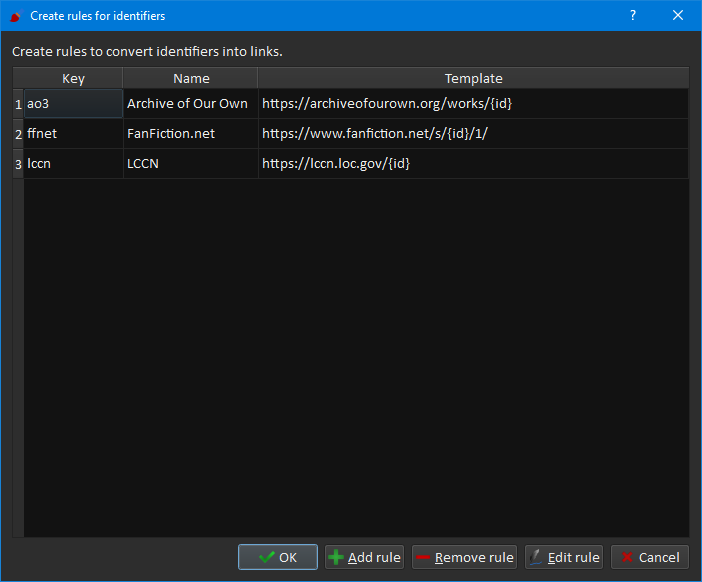

As mentioned in this post, I got stumped on a search-and-replace and corresponding regexes. I sort of know how to replace the identifier type, but I'm not sure how to proceed with this:
I made two identifiers, ao3 and ffnet, for the respective fanfiction sites.
Attachment 181789
For both of them, the {id} is a series of numbers. The number of digits can vary.

The searches should be:
https://archiveofourown.org/works/(\d+)
https://www.fanfiction.net/s/(\d+)/1/
With the replace:
\1
And set the identifier to "ao3" of "ffnet" as appropriate.
The above will add the identifier. If you want to remove the URL identifier, you should do the search again, but with nothing in the replace field, and "url" in the destination identifier.
