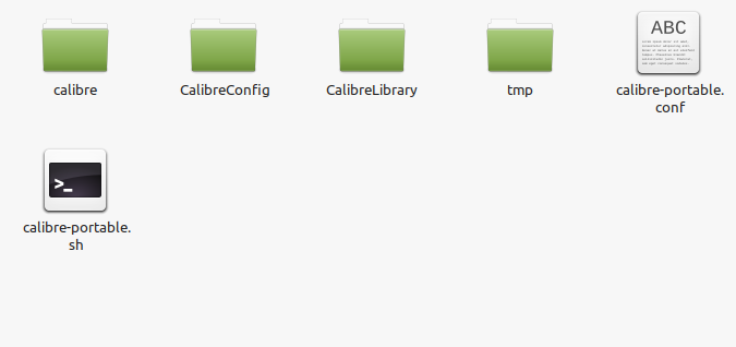

  • On a usb stick make a folder named "calibre"*
  • On a usb stick make a folder named "CalibreConfig"
  • On a usb stick make a folder named "CalibreLibrary"
  • On a usb stick make a folder named "tmp"
  • Download the tarball version of calibre you want from here
  • Extract the tarball to the folder "calibre"
  • Copy the calibre-portable.sh file from the usb folder /calibre/resources to the top level of the usb.
Name:	Screenshot from 2020-10-10 20-51-56.png
  • Open a terminal and cd to the usb stick
  • enter ./calibre-portable.sh into the terminal press enter
  • press enter to start calibre.

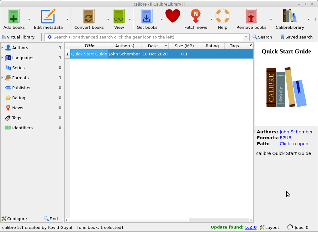

    :~$ cd /media/xxxxxxx/gbm
    :/media/xxxxxxx/gbm$ ./calibre-portable.sh
    Generating default configuration file at /media/xxxxxxx/gbm/calibre-portable.conf
    Set any non-default options here.
    CONFIG FILES:       /media/xxxxxxx/gbm/CalibreConfig
    LIBRARY FILES:      /media/xxxxxxx/gbm/CalibreLibrary
    SOURCE FILES:       *** Not being Used ***
    PROGRAM FILES:      /media/xxxxxxx/gbm/calibre
    TEMPORARY FILES:    /tmp/CALIBRE_TEMP_fEfBrFz
    Press CTRL-C if you do not want to continue
    Press ENTER to continue and start Calibre
    Starting up Calibre from portable directory "/media/xxxxxxx/gbm"
    Using library at /media/xxxxxxx/gbm/CalibreLibrary
Name:	Screenshot from 2020-10-10 20-59-22.png
You will now have a portable calibre on a usb stick for linux--I formatted my stick as ext4.
    Attachment 182609
Attachment 182611
bernie
Yes now !!! thanks for the detailed explanation I was missing several details
