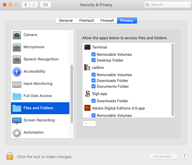

Looking in calibre's FAQs, there is an entry which seems to match your issue:
On macOS if you get permission errors when connecting a device to calibre, you can fix that by looking under System Preferences > Security and Privacy > Privacy > Files and Folders.
I've attached a screen capture from a Catalina VM.
