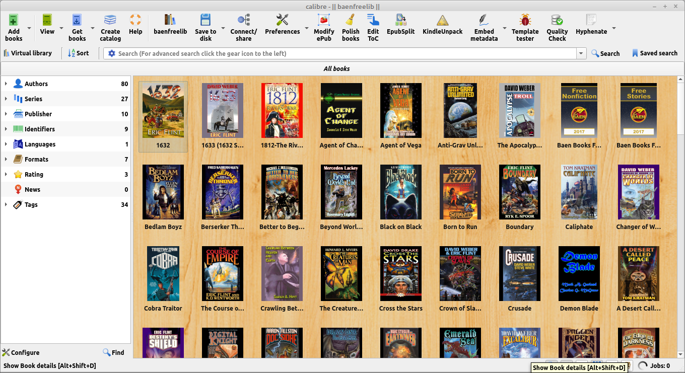

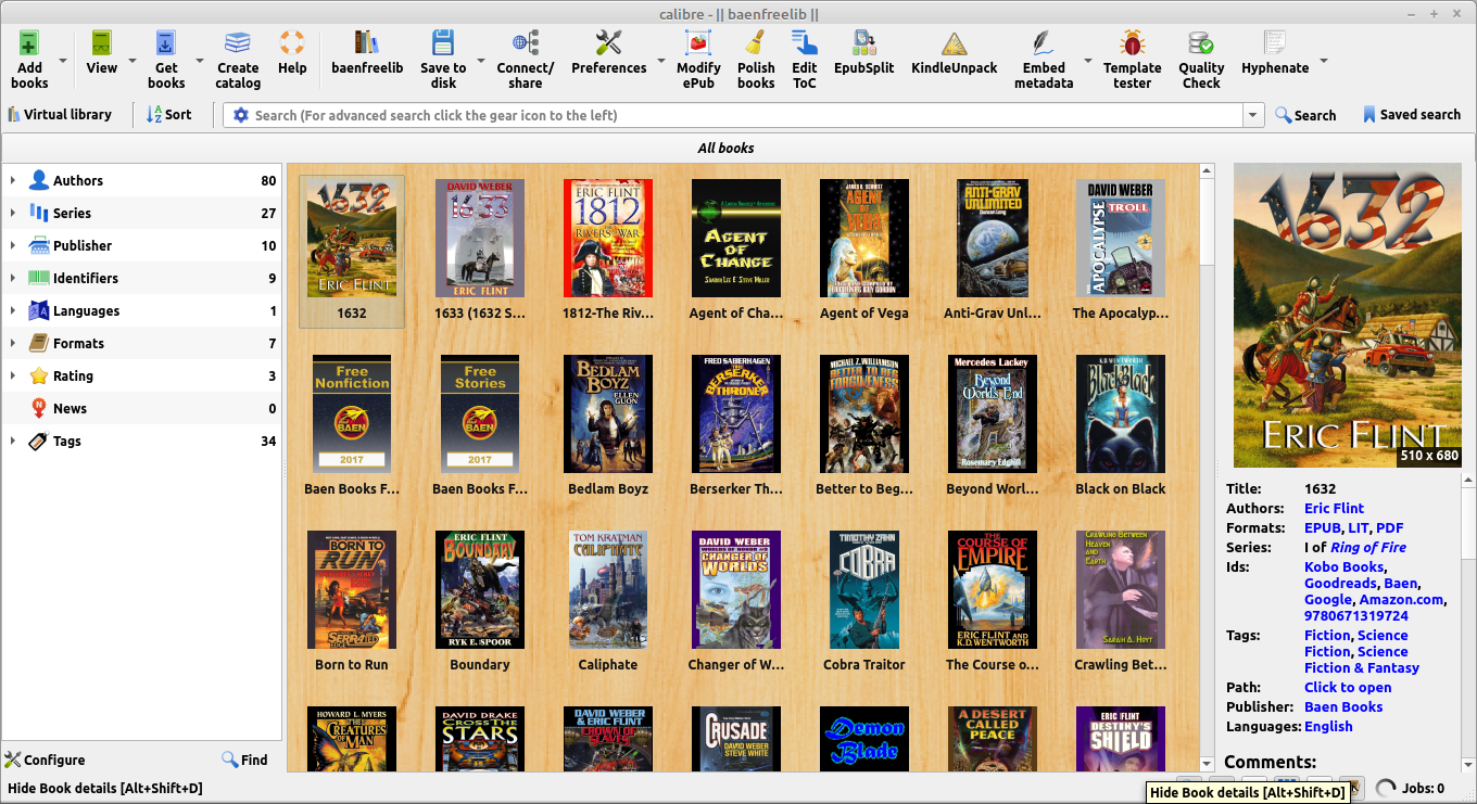

See screenshot.

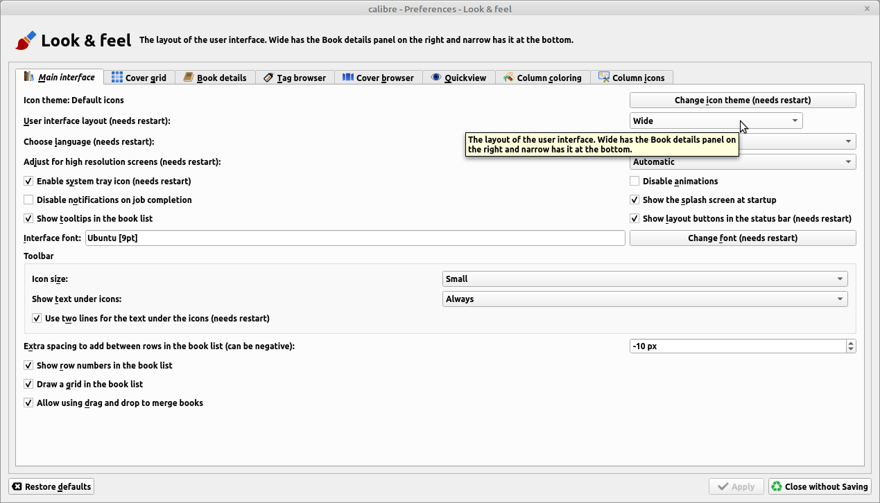

The Preferences->Look & Feel->User interface layout setting defines where the Book Details panel is shown. If it's set to Narrow it will appear under the Book List/Grid, if it's set to Wide it will appear in a sidebar on the right. If you change the setting you must restart calibre to make it take effect.
Alt+Shift+D can be used to Hide/Show the Book Details panel display.
