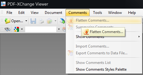

I use PDF Xchange Viewer to flatten comments. It works with my M92
Name:	Flatten comments.png

Thanks very much, M4H35H. That was a very helpful suggestion! PDF-XChange Viewer works beautifully, although the 'flatten comments' function requires a pro license if you want to save the flattened file (which I will need to do for some files).
