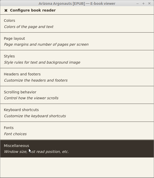

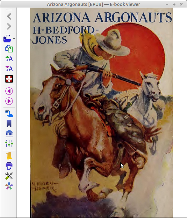

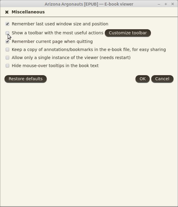

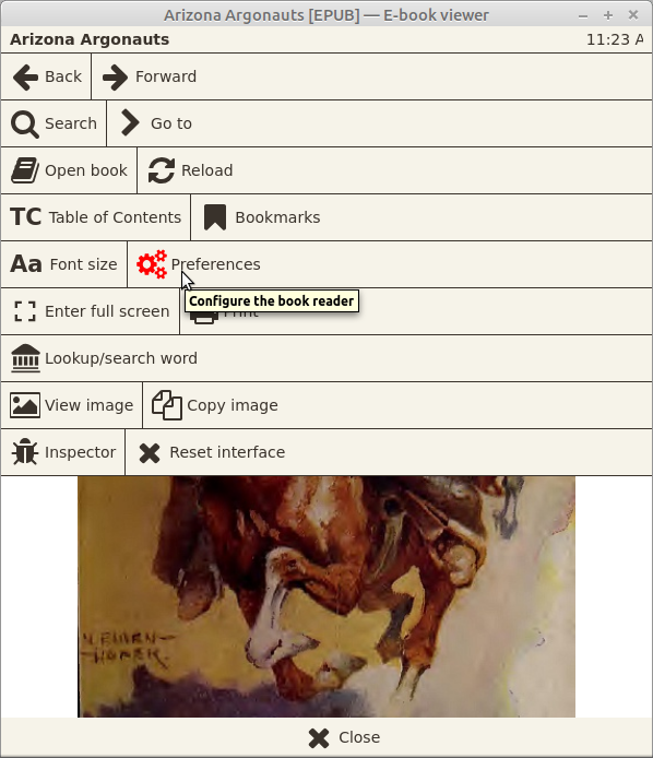

I preferred the reader layout used in 3.46.0 - with all the buttons showed, page numbers, etc.
I also don't like that so much nested, making quick navigation and tinkering complicated.
Is there a way to stay on 4.20.0, but get the old look&feel? (even if that means getting the old icons or downright downgrading)
See screenshots:

Indeed #2 seems to be exactly what I was looking for. Thank you :-D
