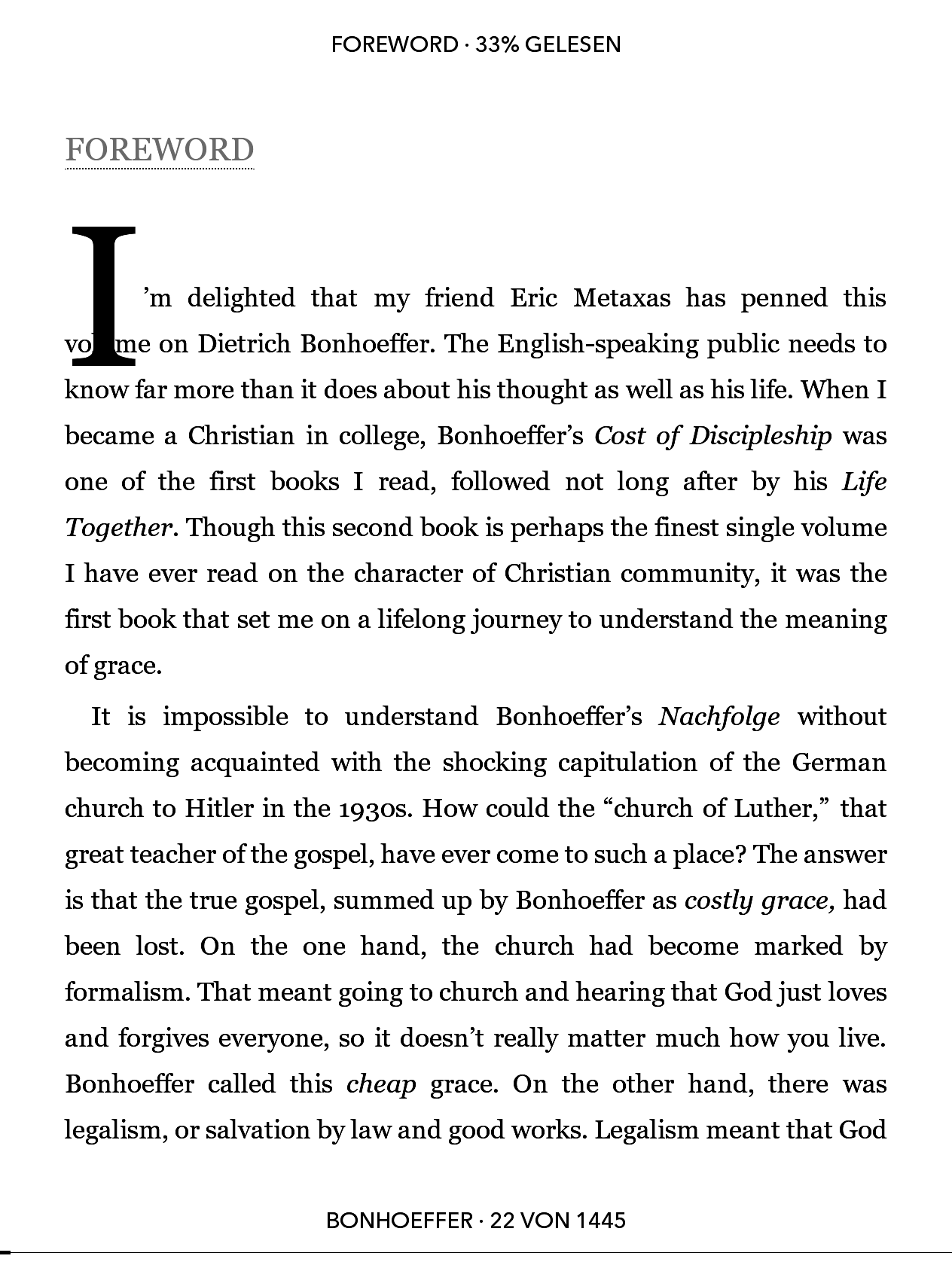

I just noticed that I totally dislike the line-height of the books I read on my Kobo (Libra H20). Most books seem to fill a complete blank line between each and every line ... and therefore waste a lot of space ... so I'm way too often forced to paginate.
I have one book where I like the line-height ... there is almost none:
ID:	186236Click image for larger version
