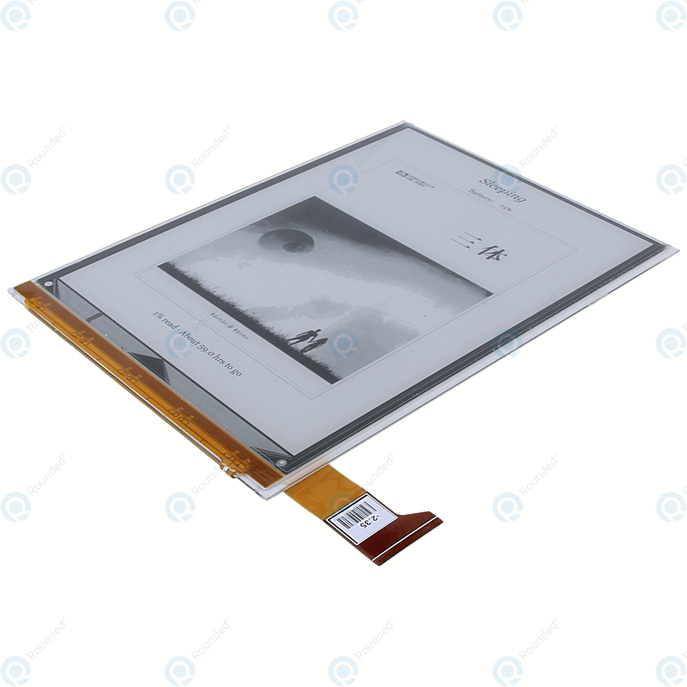

My clara's screen got broken about 1 month ago. And I've been looking for a replacement since then.
I found that the screen used on Glo HD(ED060KG1(LF)) was quite similar to the one on Clara(ED060KH6), while later one has an extra cable ( it's probably not called cable, I apologize for my poor English), since the only 2 cables on ED060KG1 looks same to those on ED060KH6, I wonder if it will work on clara?
The older screen costs around 40 bucks, so it's not a good choice for me to perform such a risky experiment.
So I'm looking for help here...
Thank you

That probably won't work. The actual screen might be OK, but the Glo HD uses IR touch and the Clara HD uses capacitive touch. The touch is probably what the third cable is for. The other two are for the light (at the bottom in the picture) and the actual screen (on the right side in both pictures).

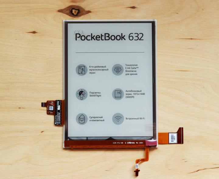

Maybe it's just too new... There is a Russian/Ukrainian website selling replacement screen for the pocketbook 632, which uses the exactly same screen as clara. The price is more than 70 bucks, plus the trouble to get it mailed, which obviously isn't worth trying.
That's why I'm looking for alternative methods, but looks like it's impossible.
