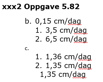

I am a colleague of the OP, Tage. We are still experiencing the problem described above with wrong numbering in nested ordered list:
Xhtml code:
<section class="key" id="key_163">
<h2 id="h2_224">Oppgave 5.82</h2>
<ol start="2" type="a">
<li>
<ol>
<li>0,15 cm/dag</li>
<li>3,5 cm/dag</li>
<li>6,5 cm/dag</li>
</ol></li>
<li>
<ol>
<li>1,36 cm/dag</li>
<li><p>1,35 cm/dag</p>
<p>1,35 cm/dag</p></li>
</ol></li>
</ol>
</section>
renders the following output when doing an ebook-convert to docx:
xxx2 Oppgave 5.82
b. 0,15 cm/dag
1. 3,5 cm/dag
2. 6,5 cm/dag
c.
1. 1,36 cm/dag
2. 1,35 cm/dag
1,35 cm/dag
Looking like the attached image.
Name:	861270 DocX listetrøbbel.png
indix is offline   Reply With Quote

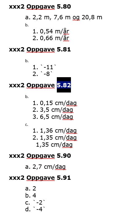

Empty ol renderes with small font
Fine. Installed the new version and the numbering is now ok. However, an empty ol is rendered with a smaller font than the rest:
tage fredheim is offline   Reply With Quote
Old 07-28-2020, 05:23 AM   #6
Posts: 45,676
Karma: 28549304
Sorry, I've spent about as much time on trying to map these two completely different numbering systems to each other as I care to. Patches are welcome for furhter issues.
