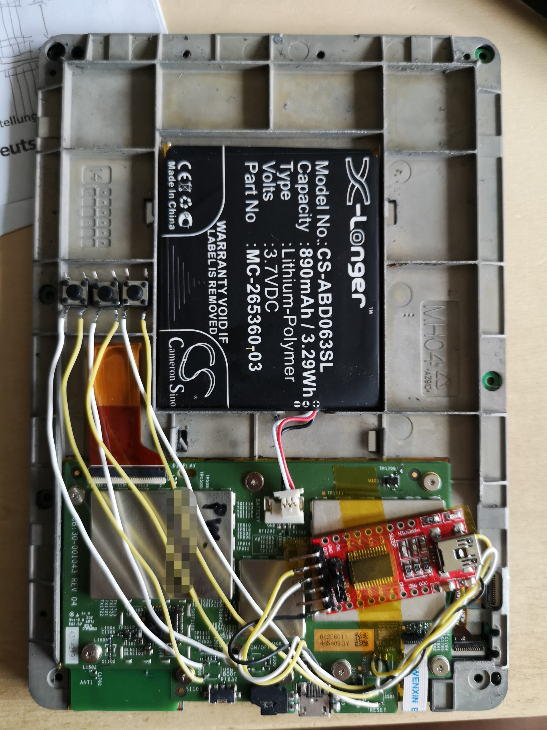

Oh, and I've built a little dev-y board out of the kindle (added the buttons and glued on a uart bridge) I might desolder the shields if i have to access the storage chip.
