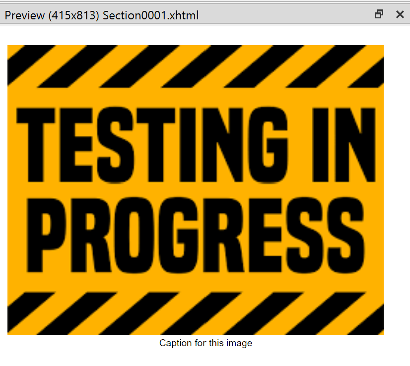

I would also add in other styling to make the image look good...of course, all that is strictly to what YOU think looks good. Here is an example:
div.image {margin:2em auto; font-size:.6em; text-indent:0; text-align:center}
div.image img {display:block; margin:0 0 .25em; width:95%; max-width:400px}
<div class="image"><img alt="" src="test.png" />Caption for this image</div>
Name:	Annotation 2020-06-22 100415.png
