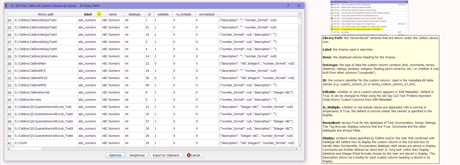

2 tools in the Job Spy plugin
There are 2 tools in the Job Spy plugin that create a matrix for either (a) only the current Library's custom column technical details, or (b) the same for all known Libraries simultaneously.
See the attached image.
https://www.mobileread.com/forums/sh...18&postcount=1
DaltonST

thanks for the info... I will try it.
That Job spy plugin is really a full program to learn and use!
Update: it worked!!
