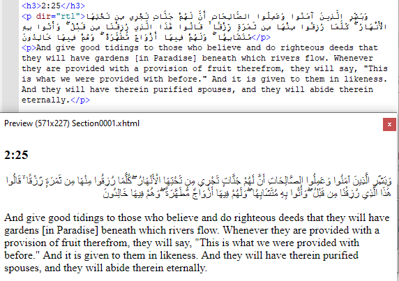

The World Wide Web Consortium recommends using dedicated bidi markup to describe RTL content, where markup is available. BTW, the IDPF adopted this position, and epub books with RTL styles will fail EPUBCheck.
Since you can't assign dir="rtl" attributes to control the alignment inline tags such as <span>, you'll have to use <p> tags (or other block level tags). For example:
<h3>2:25</h3>
<p dir="rtl">وَبَشِّرِ الَّذِينَ آمَنُوا وَعَمِلُوا الصَّالِحَاتِ أَنَّ لَهُمْ جَنَّاتٍ تَجْرِي مِن تَحْتِهَا الْأَنْهَارُ ۖ كُلَّمَا رُزِقُوا مِنْهَا مِن ثَمَرَةٍ رِّزْقًا ۙ قَالُوا هَٰذَا الَّذِي رُزِقْنَا مِن قَبْلُ ۖ وَأُتُوا بِهِ مُتَشَابِهًا ۖ وَلَهُمْ فِيهَا أَزْوَاجٌ مُّطَهَّرَةٌ ۖ وَهُمْ فِيهَا خَالِدُونَ</p>
<p>And give good tidings to those who believe and do righteous deeds that they will have gardens [in Paradise] beneath which rivers flow. Whenever they are provided with a provision of fruit therefrom, they will say, "This is what we were provided with before." And it is given to them in likeness. And they will have therein purified spouses, and they will abide therein eternally.</p>
I'd also recommend using h1..h6 tags for the surah numbers. This'll simplify generating the TOC once you're done with the Qur'an.
Note also that very few epub3 readers/apps actually support RTL text. (AFAIK, there's isn't a single epub2 app that supports RTL text.)
I.e., you might want to create an epub3 book or convert your book to an epub3 book once you're done.

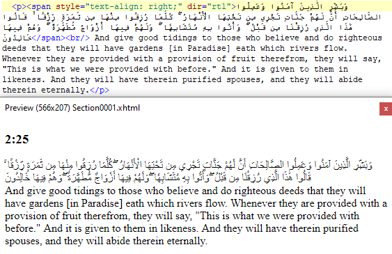

According to W3c you can use a dir attribute on a span in html5. Does this not work in epub3?
You can, of course, add a dir="rtl" attribute" to a <span> tag and the text is properly rendered as RTL text, however it'll be aligned left. What I meant is that multiline text in <span> tags can't be aligned right via CSS. (I've updated my post.)
  <p><span style="text-align: right;" dir="rtl">وَبَشِّرِ الَّذِينَ آمَنُوا وَعَمِلُوا الصَّالِحَاتِ أَنَّ لَهُمْ جَنَّاتٍ تَجْرِي مِن تَحْتِهَا الْأَنْهَارُ ۖ كُلَّمَا رُزِقُوا مِنْهَا مِن ثَمَرَةٍ رِّزْقًا ۙ قَالُوا هَٰذَا الَّذِي رُزِقْنَا مِن قَبْلُ ۖ وَأُتُوا بِهِ مُتَشَابِهًا ۖ وَلَهُمْ فِيهَا أَزْوَاجٌ مُّطَهَّرَةٌ ۖ وَهُمْ فِيهَا خَالِدُونَ</span><br/> And give good tidings to those who believe and do righteous deeds that they will have gardens [in Paradise] eath which rivers flow. Whenever they are provided with a provision of fruit therefrom, they will say, "This is what we were provided with before." And it is given to them in likeness. And they will have therein purified spouses, and they will abide therein eternally.</p>
(If you compare the screenshot with the first screenshot you'll notice that the second line is aligned left.)
