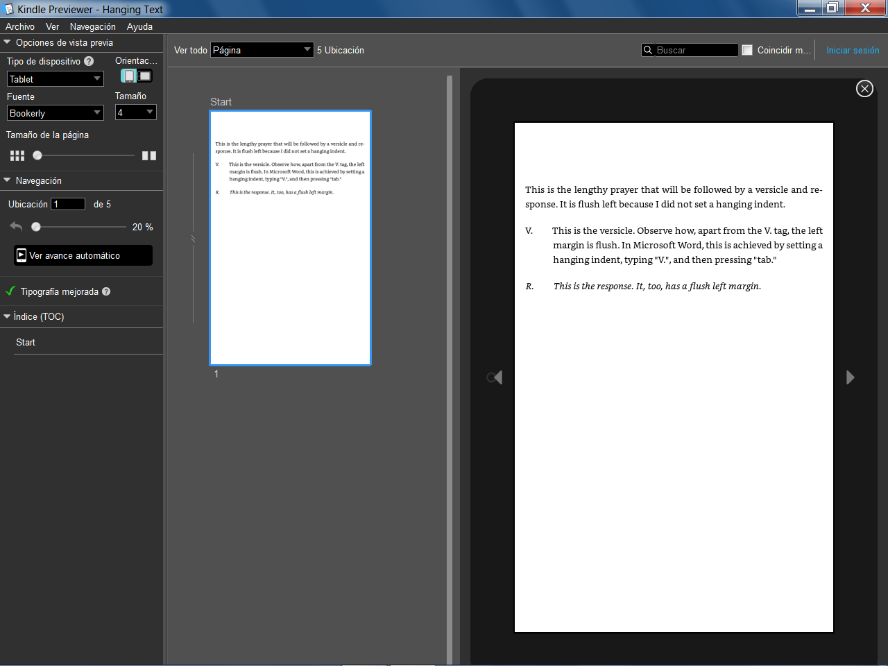

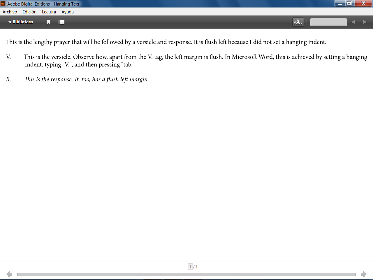

Here you can see how it looks as .KFX:
and here as .epub:
I can't attach the .kfx output but is ok. Below you can check the respective .epub.

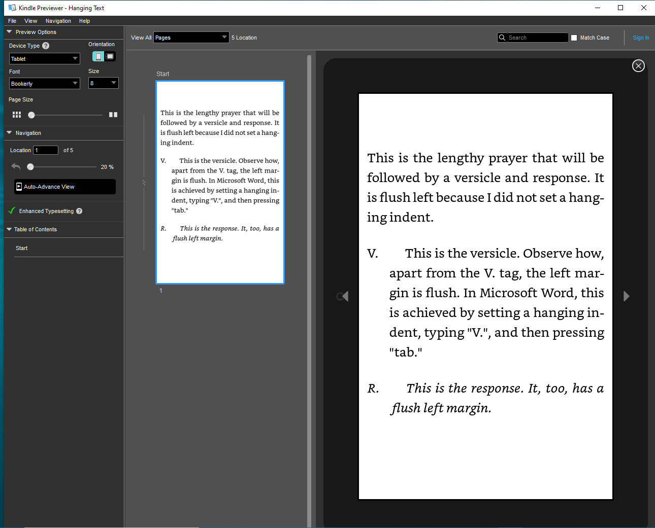

I converted your EPUB using the Kindle Previewer and everything lines up nicely for me also...until I change the font size or switch to landscape mode.
Indeed. Something has changed since you posted this:
https://www.mobileread.com/forums/sh...9&postcount=30
Now spaces are not more of fixed width. Because a margin of 3em must be the same in portrait or landscape mode (the same should happen with a negative indent of -3em).
I took a look at the book and the problem has to do with how margin and indent are handled during conversion to KFX format. Your CSS:
.hanging {
   text-indent: -3em;
   margin-left: 3em;
translates in KFX into:
  text_indent: {
    value: -9.375,
    unit: percent,
  margin_left: {
    value: 9.375,
    unit: percent,
So the indentation is being rendered as a fixed percentage of the screen size in KFX.

1. In the .xhtml file:
  <p>This is the lengthy prayer that will be followed by a versicle and response. It is flush left because I did not set a hanging indent.</p>
  <p class="hanging_tag">V.</p>
  <p class="versicle">This is the versicle. Observe how, apart from the V. tag, the left margin is flush. In Microsoft Word, this is achieved by setting a hanging indent, typing "V.", and then pressing "tab."</p>
  <p class="hanging_tag italic">R.</p>
  <p class="versicle italic">This is the response. It, too, has a flush left margin.</p>
  <p>This is another lengthy prayer that will be followed by a versicle and response. It is flush left because I did not set a hanging indent.</p>
2. In the .css stylesheet:
p {
   text-indent: 0;
   text-align: justify;
   margin-bottom: 0;
.italic {
   font-style: italic;
.hanging_tag {
    float: left;
    display: inline;
    text-align: left;
    width: 1.5em;
.versicle {
    display: block;
    padding-left: 18%;
    text-align: left;
    width: 81%;
This code works fine both, in portrait and lanscape mode, except with font size "10" in portrait mode (but is difficult to think that somebody wants to read with such font size). Also with smartphones and font-size "9" or "10" (again, those are huge font-size to read in a smartphone; I think nobody will use those sizes to read in a phone) it can be some issues with the alignment.
In landscape mode all seems to be ok. Below I attach the respective epub (by the way, .KFX has some serious issues with the property "float" —but not with the present aproximation—, that property works much better in .kf8).
Rubén
