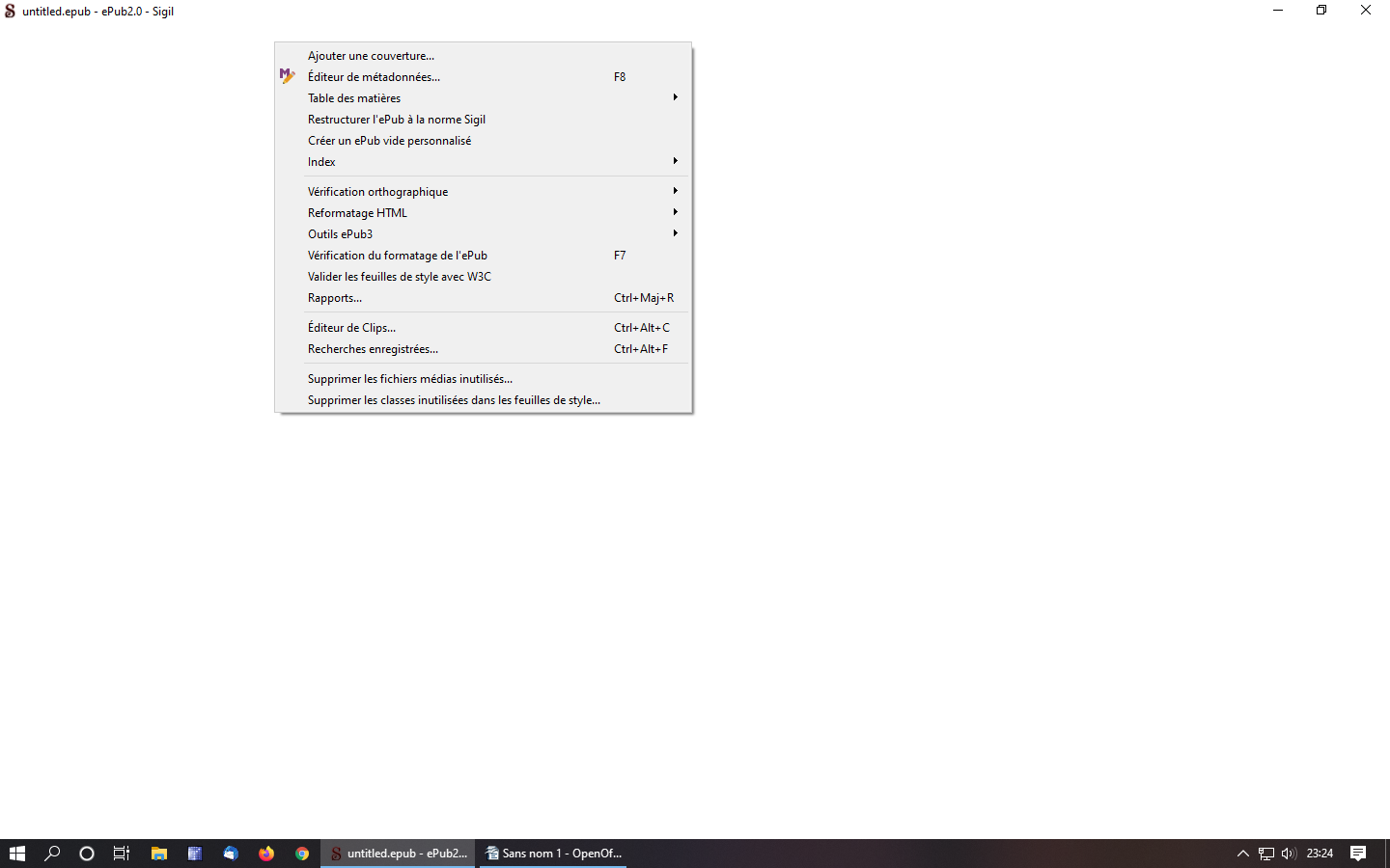

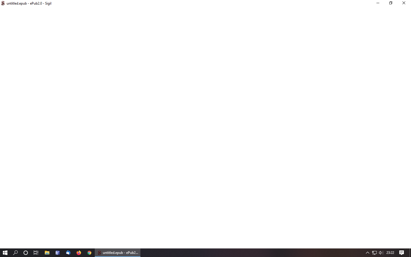

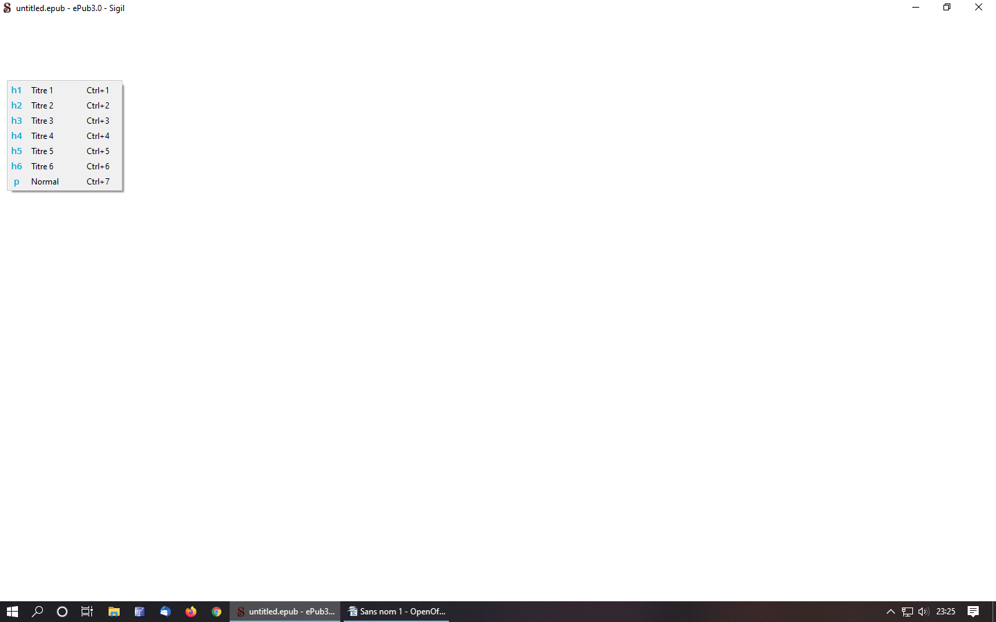

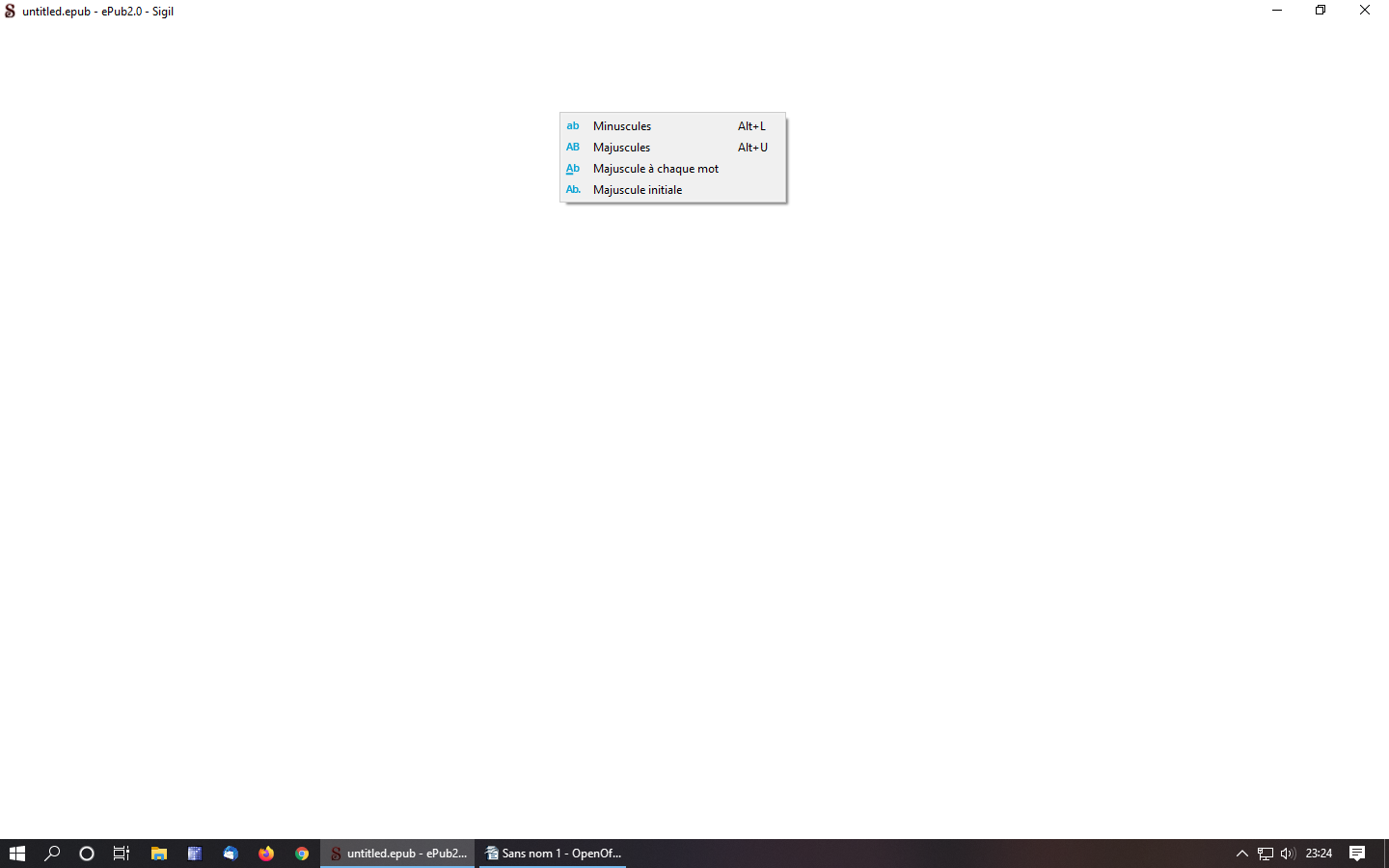

Hi,
I am new in this forum and I am a new user of Sigil.
I downloaded Sigil-1.2.0-Windows-x64 on a desktop with Windows 10 and installed it. When I open it, the windows is blank or white with nothing in it. When I click where the menu is supposed to be, the menu options pop-up. I enclosed screenshots of it.
I remove it including the sigil-ebook folder in the AppData folder. I did a sfc /scannow, I made sure I have Microsoft Visual C++ 2017. I re-installed Sigil and again I have the same issue.
Then I installed Sigil-1.2.0-Windows-x64 on a laptop with Windows 10 and it works perfectly.
Do you know where this bug on my desktop can come from?
Thank you in advance for your help.
Fred

At a guess, I'd say that your display card/driver on that machine is insufficient for the version of Qt being used with Sigil 1.2.0. Can't say as I've ever seen it manifest in quite that way before, though. Make sure you're using the very latest driver possible for your video card.

Are you by chance setting Windows to run Sigil in some Compatibility mode? Or what about using a dark theme that might confuse Qt?
On searching the web for "Windows app open to white screen", I found the following link for a different Qt app:
https://community.atlassian.com/t5/H...w/qaq-p/277535
Which says:
What also seems to work:
Add a new user environment variable named "QT_OPENGL" with the value "software" and reboot/relogin
Perhaps the same thing will work for Sigil since it is a Qt app?

The video card is a NVIDIA GeForce 7025 / nForce 630a. Driver : 9.18.13.908 (30/01/2015).
Fred31416 is offline   Reply With Quote
Old 05-08-2020, 10:16 AM   #14
DiapDealer
DiapDealer's Avatar
Posts: 28,931
Karma: 207182180
That really is a legacy card. In fact, I don't even see where NVIDIA offers an official driver that supports Windows 10 for download.
That particular card has posed a problem, it seems, for many people when trying to upgrade to Windows 10.
