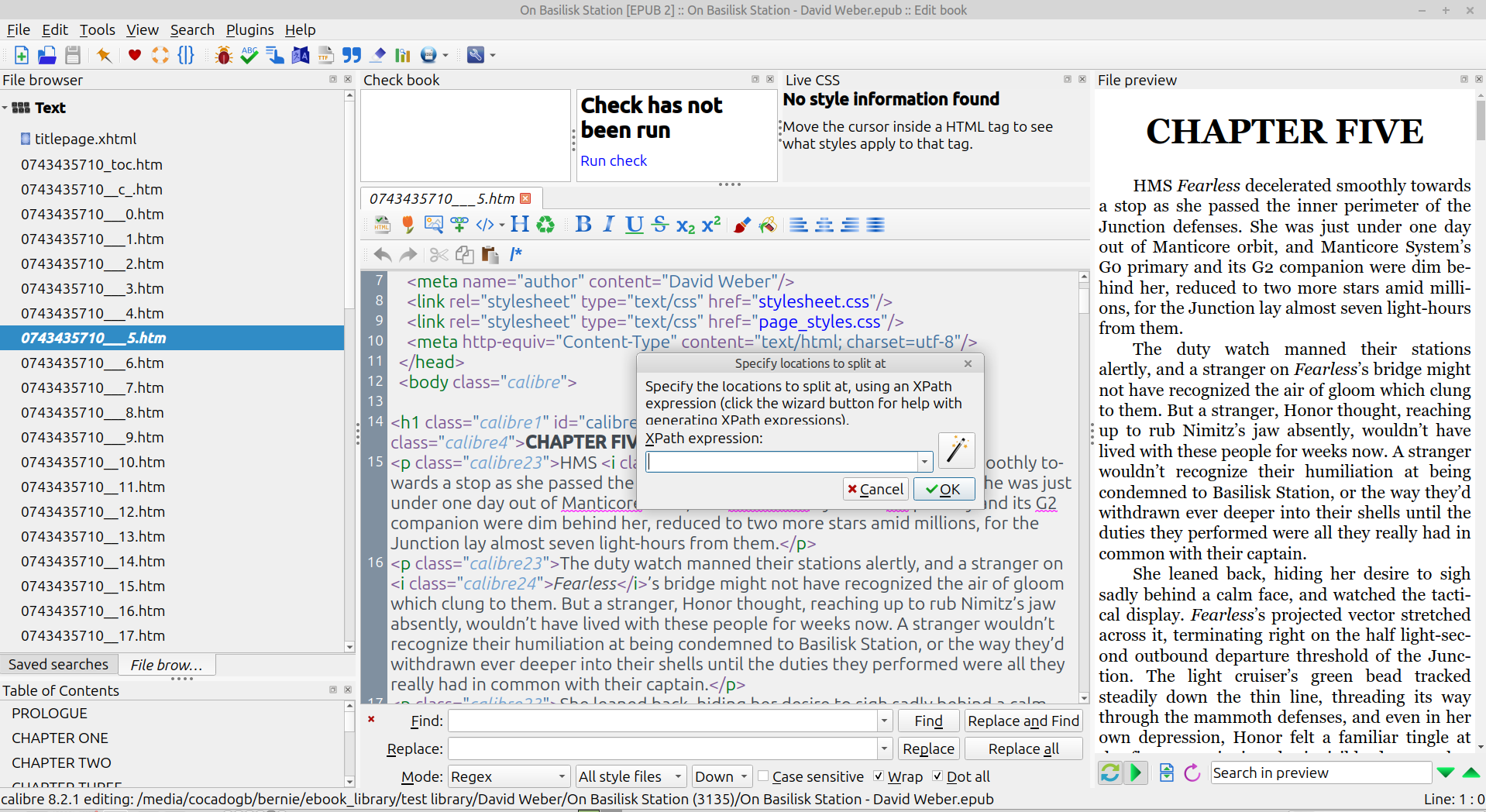

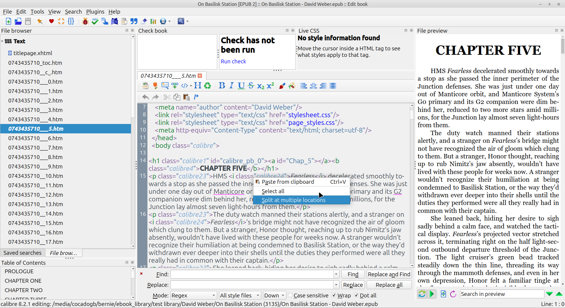

https://manual.calibre-ebook.com/edi...ing-html-files
You can also split a single HTML file at multiple locations automatically, by right clicking inside the file in the editor and choosing Split at multiple locations. This will allow you to easily split a large file at all heading tags or all tags having a certain class and so on.

Thanks for this Bernie, it seems that my initial XPath expression was wrong, though I'm not completely sure why, but hey, at least I found one that kinda works. Thanks again for your help!

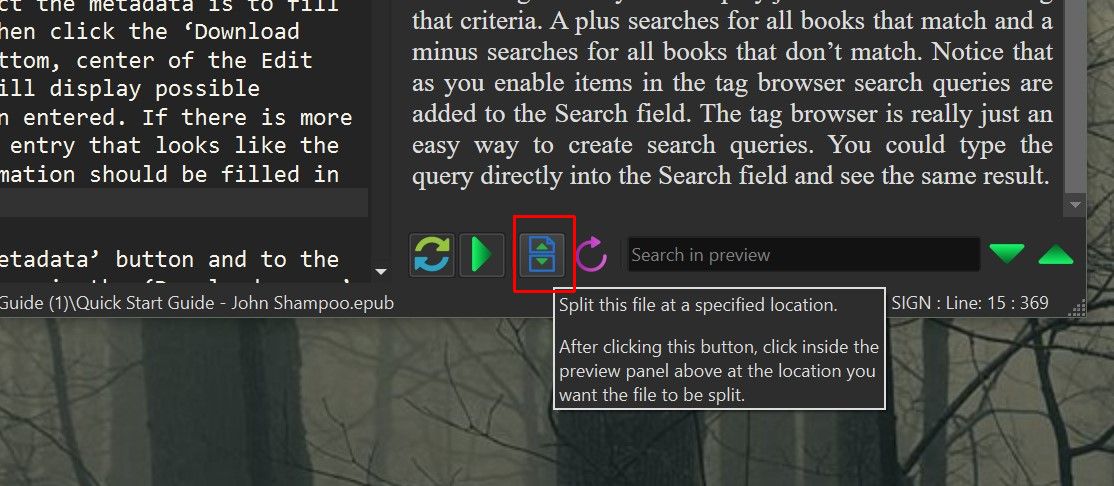

@corban - you can also split text arbitrarily in the Preview panel:
