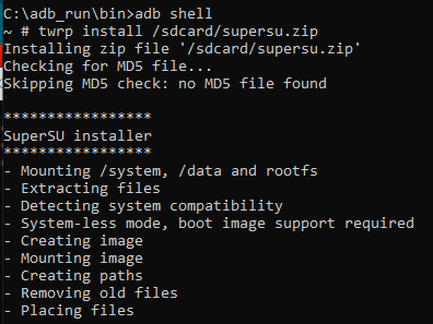

ROOT RK3368 (TWRP console)
TWRP only work in CONSOLE
Download Twrp and SuperSu
https://mega.nz/file/kYxjibqT#gqmriW...z8RPuY8V9BV98w
1. RK_Driver_Assistant_
2. RK_Android_Tool_
a. load config_16.cfg
b. SWITCH to LOADER
c. Flash twrp.img
3. After the flash IMMEDIATELY boot into recovery (may replace recovery)
or (-- Adb_run >>> A - Adb / Fastboot manual input)
++++5. TWRP Console -- Root -- SuperSu
a. 1SupersuInstall.zip
b. 2supersu2.zip
6. Reboot
Fake Wifi (Xposed Module)
https://play.google.com/store/apps/d...fakewifi&hl=ru
AnyDesk - need enable - background process
https://play.google.com/store/apps/d...anydeskandroid
