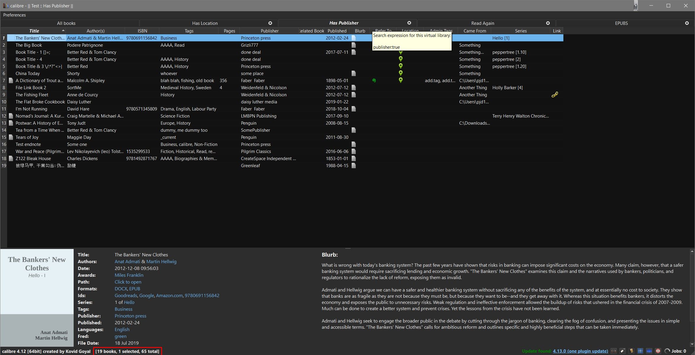

FYI - if you create a Finished virtual library as I first suggested, when you switch to it the total is displayed in the status line, viz:
Name:	Annotation 2020-04-12 105228.jpg
