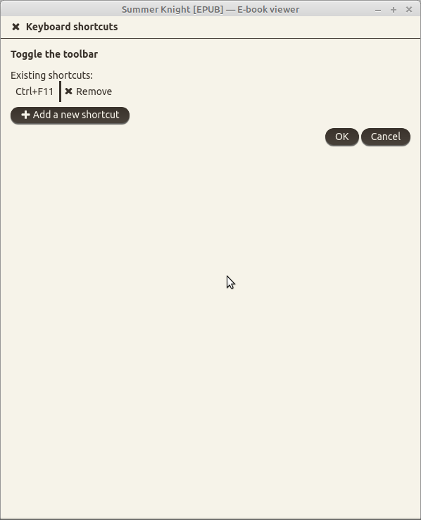

@DavidTC - hit Ctrl+F11 and you should be able to see the toolbar. Click the Paint Pot and try changing to a standard theme
If no joy with that, hit Escape and then click Reset Interface
If that doesn't 'work', I'm out.

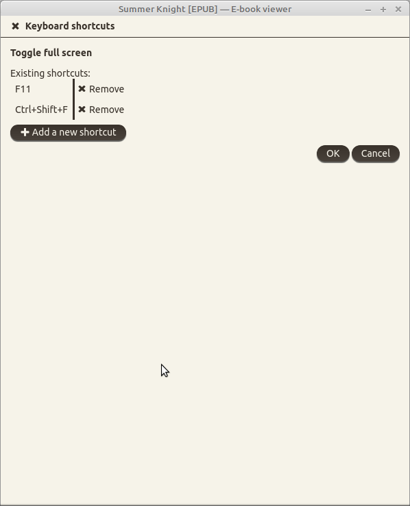

It wasn't that. If I get the window to go full screen, and hit Alt+F4 while it's open...the next time I open a boot,and only the next time, it works. Unfortunantly...I'm not sure how I even get them full screen, I just got it happen by randomly clicking. What's the hotkey for that, anyone?

Name:	Screenshot from 2020-04-05 23-46-39.png
ID:	178137   Click image for larger version
Name:	Screenshot from 2020-04-05 23-49-17.png
