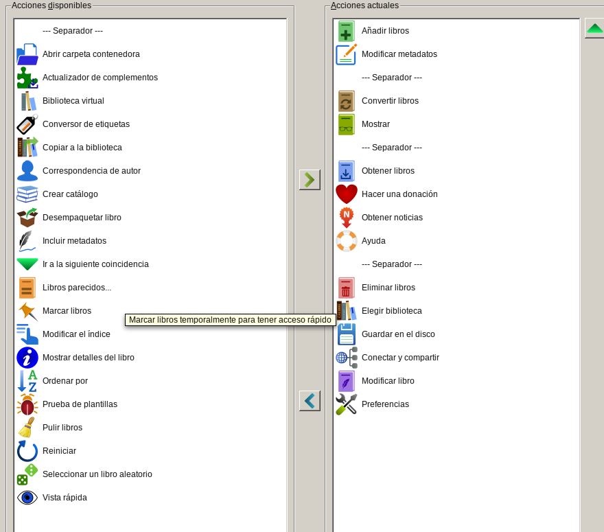

This is what Davidfor commented on in previous messages
"The icon is a pen, although it is probably a pen. If you don't have it in the toolbar or in the menu, you can add it using the" Toolbars and menu "preferences page. and I found him following his instructions.
What it says by displaying the latereal arrow is:
Include metadata in book files.
And Include metadata in the archives of a specific format of the selected books.
Old 01-11-2020, 03:43 PM   #11
Posts: 51,651
Karma: 179962432
Embed metadata would normally be a button in the toolbar or on a menu. The icon is a a feather, though it is probably a quill.
As I read it—see the quote above from davidfor—he said the icon is a feather/quill not a pen. I will admit to wondering if this is a translation issue since feather and quill both appear to translate to Spanish as pluma.
I added it using Preferences => Toolbars and Menu => The main toolbar.
The icon varies according to the operating system, I want to make that clear. The first image is in Windows and the second in Linux
ID:	177891   Click image for larger version
