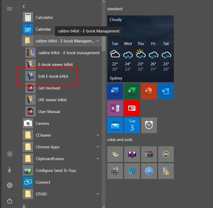

Any luck with reverting to an earlier version?
Have you tried running the viewer standalone?
