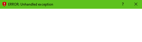

I unticked in properties --> behavior the PDF checkbox in order to view my ebooks via an external viewer (Adobe Acrobat Reader DC). However, this results in a fatal error when trying to open a pdf: A blank window titled "ERROR: Unhandled exception" appears and calibre crashes.

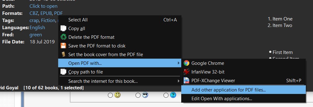

- try adding Acrobat to calibre's Open With feature to see if it works there:

Thank you for mentioning the Open With feature, I didn't know that before. I tried to select Acrobat Reader via the suggested readers and via manually browsing as well (it seems to differentiate there, since the logos are different), but neither of them did work.
I reinstalled Acrobat Reader and cleaned the Registry, but that didn't help either (Although I'm not sure if that worked correctly, since it showed the last used files...). Afterwards, I tried selecting it via Open With again as mentioned above, without success.
Interesting is that it does work when I click Open With --> Adobe Acrobat Reader DC, but not by doubleclicking the book like I always tried before.
The error message I always recieve is this (hope this works). It just stays blank, and after a short time, Calibre won't react anymore.
Another thing that might help diagnosing the problem: I recieved once an error message that said something about "module propsys" or similar, but I can't replicate it currently, and it also just appeared for a very short time before closing itself.

It crashed as expected and did show the same blank window as before.
Also, I somehow managed to recreate the 2nd error message, and although I couldn't take a screenshot or copy it, it indeed matched the log (it read ImportError: No module named propsys, like the error at the end of the log).
