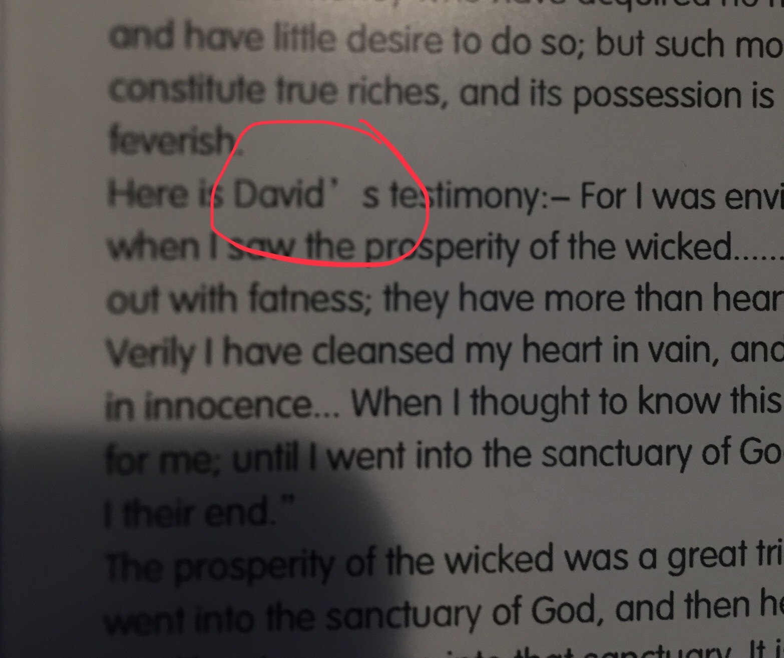

The ereader (supernote) is primarily used in Chinese and Japanese so there's still a few bugs with the english version. For some reason theres always a space after every smart apostrophe or quote mark, it started getting kind of annoying so I decided to figure out some way to fix it.
Thanks for the picture.
Are your books marked with the proper language lang + xml:lang in the HTML?
<html lang="en" xml:lang="en">
Is your book marked as English in the EPUB metadata? (dc:language "en")
And what exact ereader is this?
Does it happen if you embed/use a different font to display your ebook?
Hmmmm... it seems like the font could be accidentally rendering it as a full-width character.
For example, see Wikipedia article on "Chinese Punctiaton":
In Simplified Chinese, the European-style quotation marks are always used in horizontal text. Here, single quotation marks are used when embedded within double quotation marks: “…‘…’…”. These quotation marks are fullwidth in printed matter but share the same codepoints as the European quotation marks in Unicode, so they require a Chinese-language font to be displayed correctly.
or this bug in Word:
https://answers.microsoft.com/en-us/...9b31bf5&page=6
I remember seeing LibreOffice locale bugs about similar things over the years too. If I remember correctly, it's usually something along these lines:
"Computer/OS/Program set to Asian language, trying to type book in English. Program/Font is still making Asian typography assumptions."
Technical Note: It could also be built into the OpenType fonts in your device itself... there are OpenType features like:
fwid = Full Widths: Substitutes proportionally spaced character with full-width versions (esp. for Latin letters within Chinese)
Also see Microsoft's OpenType fwid explanation:
Tag: 'fwid'
Friendly name: Full Widths
Registered by: Adobe
Function: Replaces glyphs set on other widths with glyphs set on full (usually em) widths. In a CJKV font, this may include “lower ASCII” Latin characters and various symbols. In a European font, this feature replaces proportionally-spaced glyphs with monospaced glyphs, which are generally set on widths of 0.6 em.
Example: The user may invoke this feature in a Japanese font to get full monospaced Latin glyphs instead of the corresponding proportionally-spaced versions.
Recommended implementation: The font may contain alternate glyphs designed to be set on full widths (GSUB lookup type 1), or it may specify alternate (full-width) metrics for the proportional glyphs (GPOS lookup type 1).
Application interface: For GIDs found in the 'fwid' coverage table, the application passes the GIDs to the table and gets back either new GIDs or positional adjustments (XPlacement and XAdvance).
UI suggestion: This feature would normally be off by default.
Script/language sensitivity: Applies to any script which can use monospaced forms.
Feature interaction: This feature is mutually exclusive with all other glyph-width features (e.g. 'tnum', 'halt', 'hwid', 'palt', 'pwid', 'qwid' and 'twid'), which should be turned off when it’s applied. It deactivates the 'kern' feature.
which is why I suggest embedding a different font and seeing if that works.
Thanks for the info. Here's the website of the product. I actually contacted them and they said they would create a new font on the device that would fix the issue by the end of the month. For now it's easy enough just to unsmarten the punctuation because it fixes the spacing. Changing the font in Calibre doesn't seem to affect anything because the device seems to use its own fonts. I'll keep experimenting, I'm still very new to editing ebooks and understanding the html and such.
