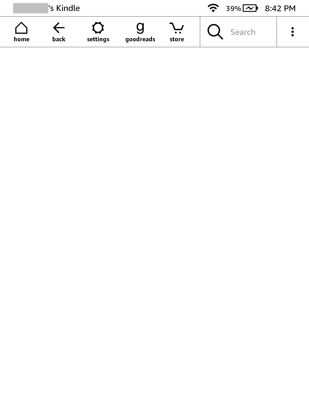

I have this same issue:
My books do show up in search, and I can open them. I've tried multiple restarts and putting the firmware file onto the USB drive and pressing update, but nothing has worked. This started after the upgrade to 5.12.4.

Originally Posted by Barbara1955 View Post
Try ALL ITEMS ...
If you look at the screenshot, it's completely blank below the main toolbar. No way to even select filter and sort.
@merlin04
Can you try manually reinstalling the 5.12.4 firmware?
https://www.amazon.com/gp/help/custo...MQC26VQQMM8XSW
If that doesn't fix things, I think only thing you can do is report to Amazon and wait for them to fix it.
