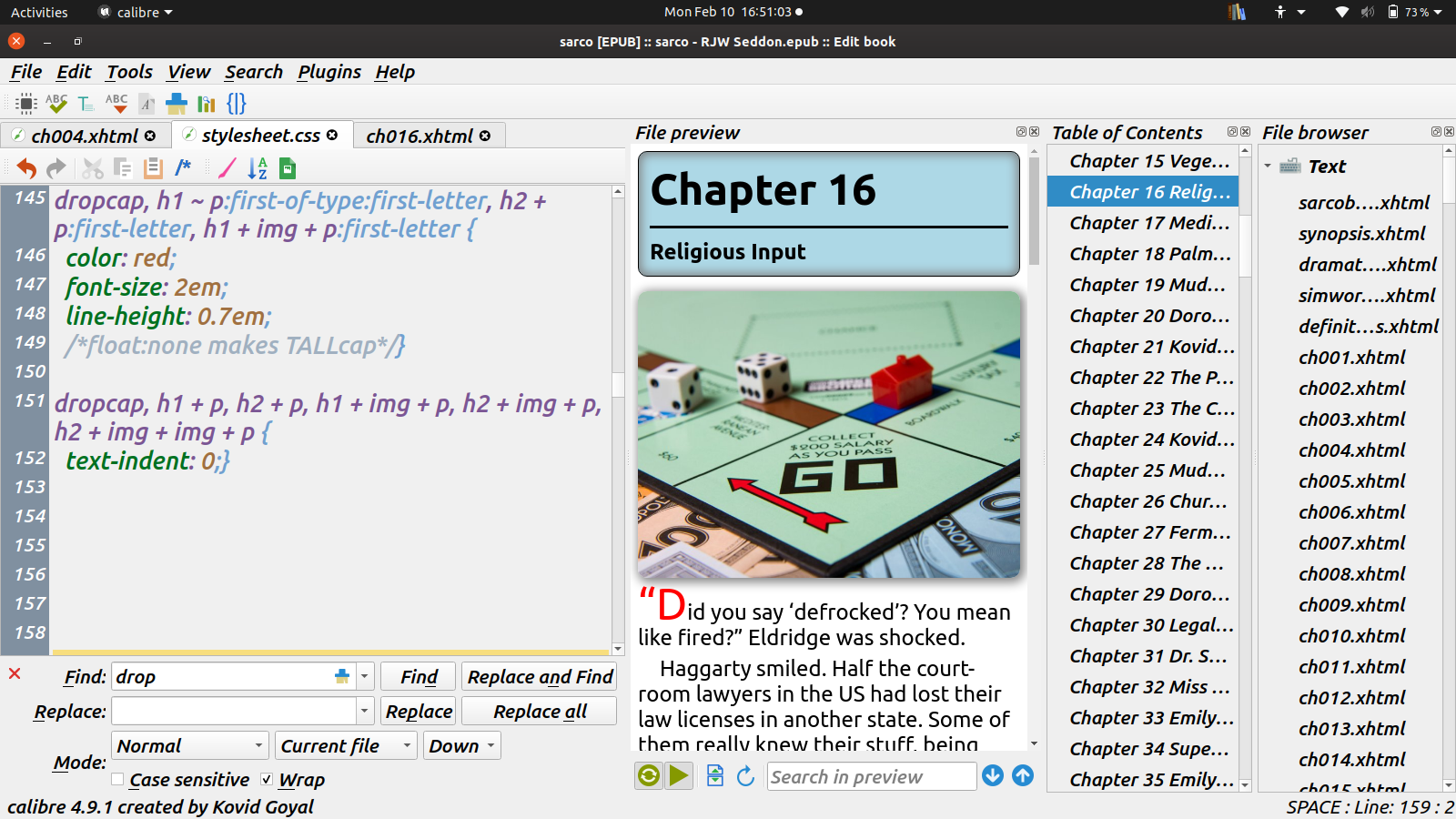

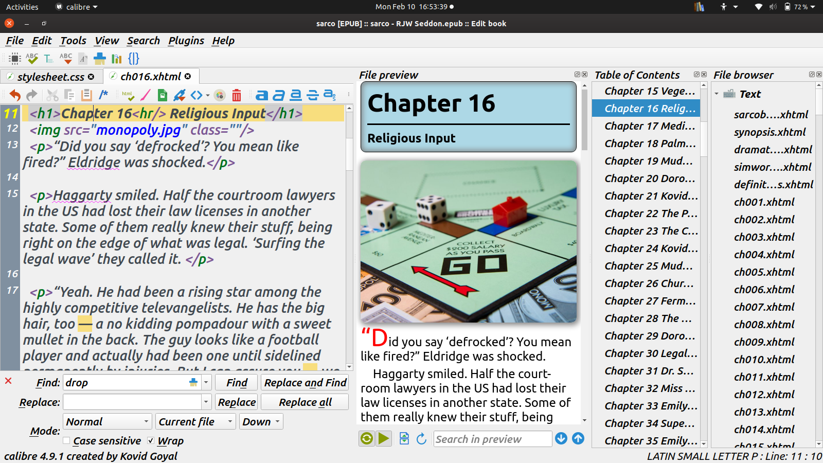

<style>
dropcap, h1 ~ p:first-of-type:first-letter, h2 + p:first-letter, h2 + img + p:first-letter, h2 + img + img + p:first-letter {
color: red;
font-size: 2em;
line-height: 1em;
float: none;
/*float:none makes TALLcap*/}
dropcap, h1 + p, h2 + p, h1 + img + p, h2 + img + p, h2 + img + img + p {
text-indent: 0;}</style>
The above works good for me. I put the dummy word 'dropcap' first to alphabetize the css. The 'text-indent:0;' makes the first paragraph of a chapter nonindented for the dropcap. I inserted 'img' in between 'h1' and 'p' because quite often I want a dropcap after an h1 which is followed by an image, then a p. This method automatically takes care of any double-quote starting the first paragraph. I prefer a TALLcap to a DROPcap, but it is a one word change. You can add h3 etc. if necessary. With this method you do not have to do anything at all in the text itself. Best regards, Pop
Name:	Screenshot from 2020-02-10 16-51-03.png
ID:	177061   Click image for larger version
Name:	Screenshot from 2020-02-10 16-53-39.png

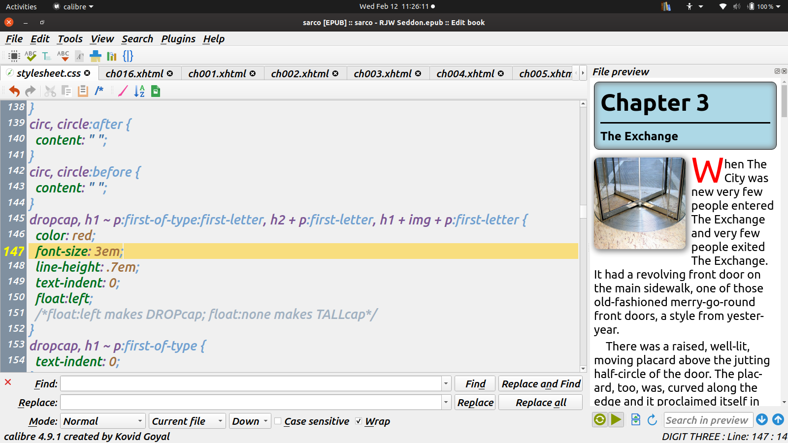

convert tallcap to dropcap
Sorry if I was not clear. change 'float;none' to 'float:left' and the tallcap will descend. Tweak 'line-height' and 'font-size' to taste. best regards, Pop
Name:	Screenshot from 2020-02-12 11-26-11.png
