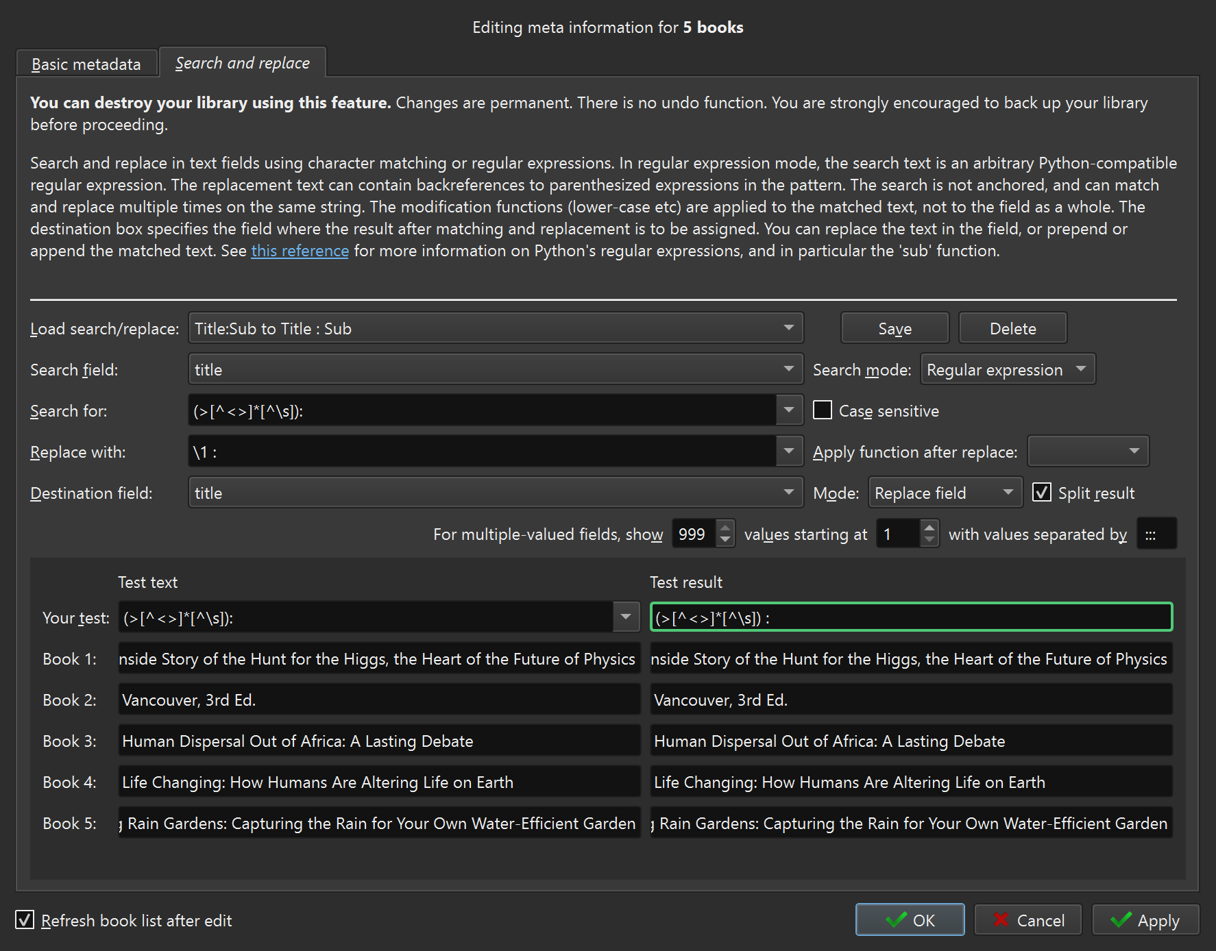

This is an old thread so I hope somebody will pick this up. In the titles I've tried to replace '*:' with '* :' but I'm doing something wrong.
To ensure that I'm not adding a duplicate book to my collection, I use Everything to search in my files for the new title I consider adding. It's pretty much instant and doesn't require Calibre but titles which may have a colon attached to the main title, in Windows has to be represented by '*_' and will not show in the search results. Consequently, in Calibre I need to replace: 'title: subtitle' with 'title : subtitle'.
In latest Calibre I'm using the Edit meta information with Search and replace selecting: Search and Destination fields as title. Other parameters are Regular expression and the Mode as Replace field.
As per your instructions, the Search for I have as \>.+?\w\:\w and the Replace with as \1 :, however it doesn't work...
Any guidance as to what I'm doing wrong?
Cheers!

The slash1 (\1) requires a capture in the search
(\w):
Whatever (a word, in this case) was inside the () will be used

Thanks for your response. I wasn't being very clear (used the wrong expression). Better I show you what I fill out with five book examples four of which have Title:Subtitle which I would like to change to: Title : Subtitle
