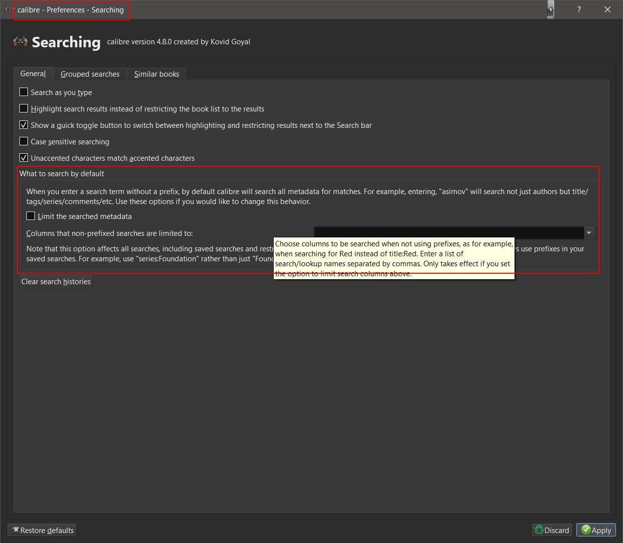

See Preferences->Tweaks "Author sort name algorithm" and have a look at the "Use author sort in Tag browser" tweak.
And for searching, check these settings

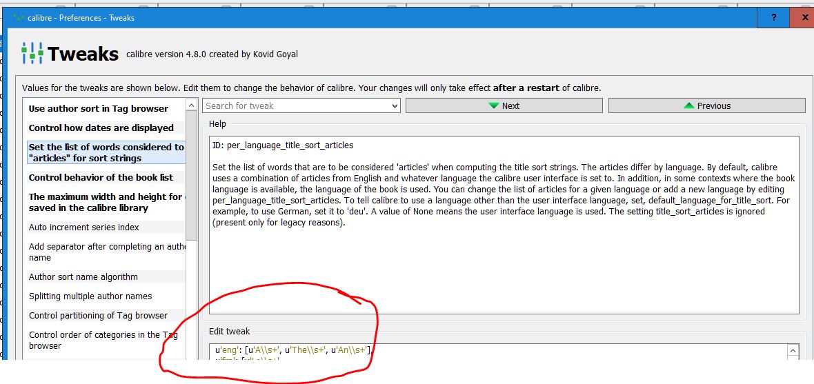

There's a Tweak that defines articles by language
Remove the English line and see if it works for you

Old 01-10-2020, 11:23 AM   #4
Posts: 31,370
Karma: 62500000
While this would probably get the job done. It is like using a bachoe to pull a weed. (and I do not know where else, Calibre makes use of these values. So this gets a : NOT RECOMMENDED )
BR's way is the official, and recommended way
