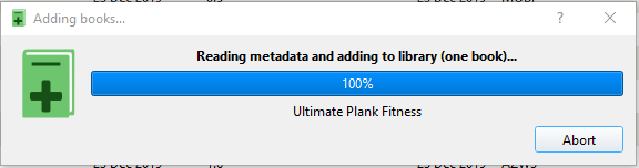

Been using Calibre for over 6 months, suddenly started having problems adding new books, get the following and have to end task and restart Calibre
Here is the correct attachment with the error message
Name:	Annotation 2019-12-26 074204.png

That is not an 'Error" message: That is a normal Status message box.
What is NOT normal, is it is 'hung' at that point (from your description).
Is your Library on a LOCAL ATTACHED drive? Is / has that drive folder been excluded from cloud backup.
Calibre has to write files and make folders, make an entry into Metadata.db (the heart of Calibre) and maybe even fetch some metadata from the web.
Until that is done, that singing 'Fat Lady (message)", won't return to her seat (go away).
If the drive is local: then the usual culprit for interference is you Anti-Virus-Security software. The other one is failing drive: Run the disk check utility for your OS
If you put the Library directly into the cloud: the usual culprit is the users failure to read the FAQ warnings.

Turns out this only happens when adding a books that is already in the Calibre, looks like the Ok or Cancel option is hanging...

AH! Betcha 'the Off screen" bug is striking again (another dialog is waiting for confirmation).
Just for giggles: What is your settingS in Preferences: Adding books: Auto-Merge (on the adding actions tab)

Auto merge was unchecked, I’m going to install the 4.7 update, turns out that my laptop is usually hooked up to a second display and these error messages may be the ones that appear on the missing display...
Installing the new update resolved the problem, the “Duplicate found” dialog was most likely try to display on the missing scone display.
