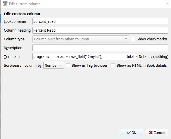

Try this:
program:
	read = raw_field('#pages_read');
	total = raw_field('#total_pages');
# if total <= 0 (or undefined), set read to 0
	read = cmp(total, 0, 0, 0, read);
# make sure the dividend (total) != 0
	total = cmp(total, 0, 1, 1, total);
	percent = multiply(divide(read, total), 100);
	cmp(percent, 0, '', '', format_number(percent, "{0:2d}"))
The custom column definition looks like this:

program:
	cmp(percent, 0, '', '', format_number(percent, "{0:2d}%"))
The #pages_read and #total_pages custom columns are integers.
