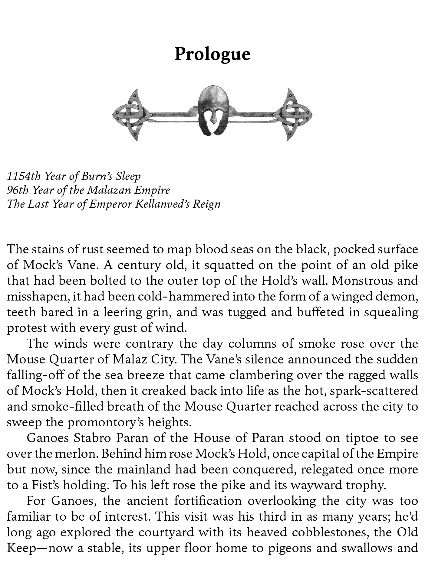

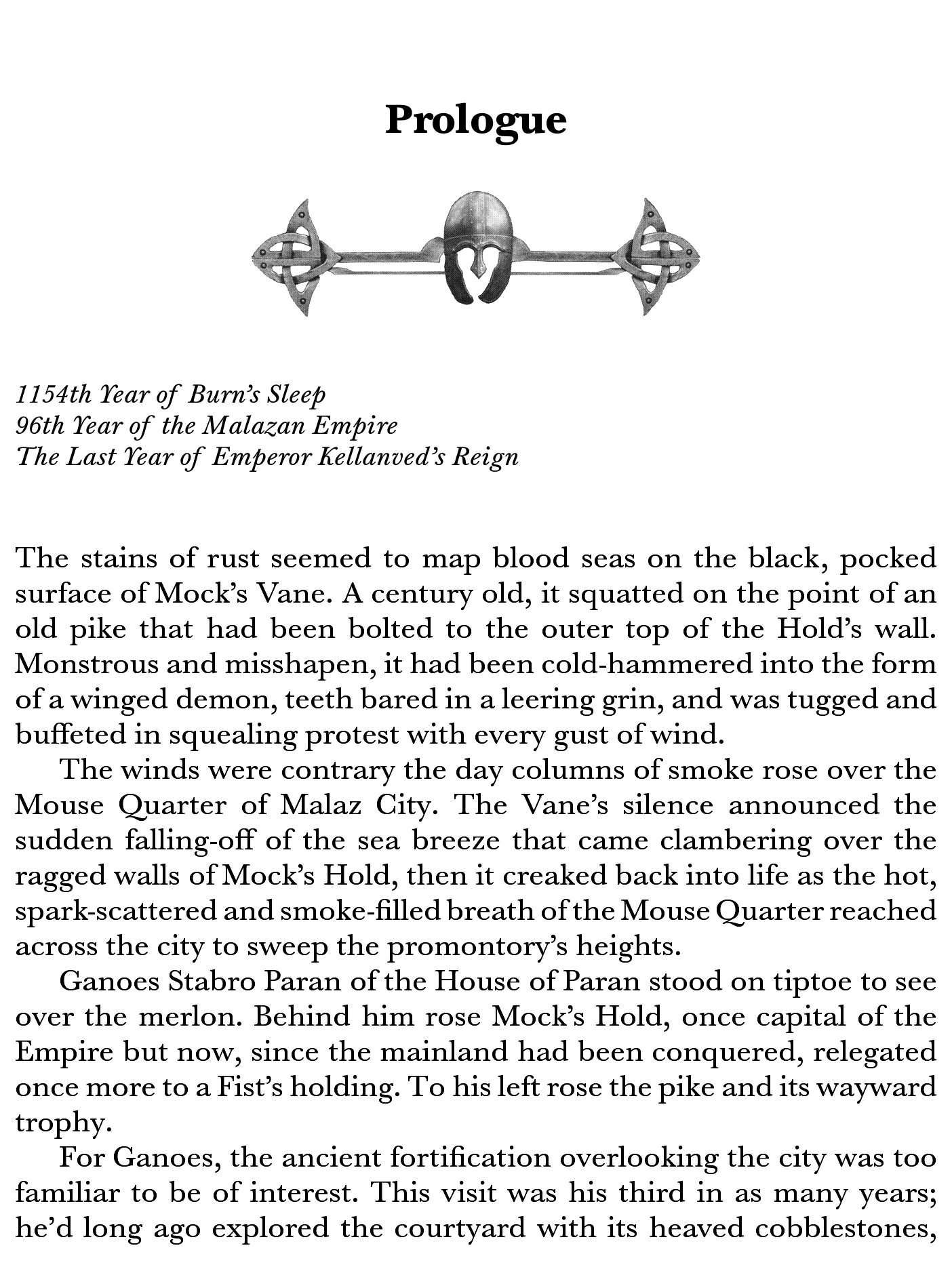

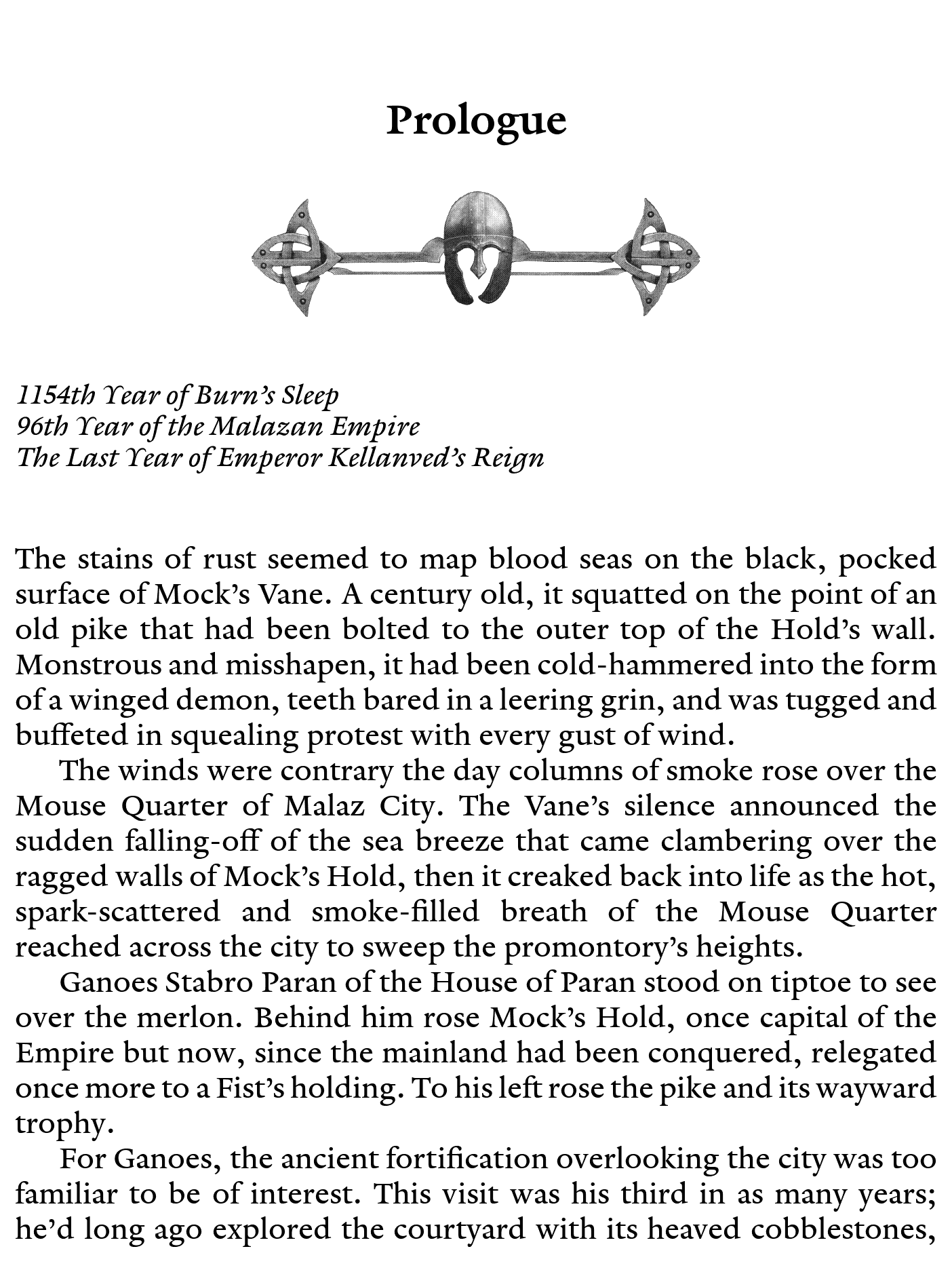

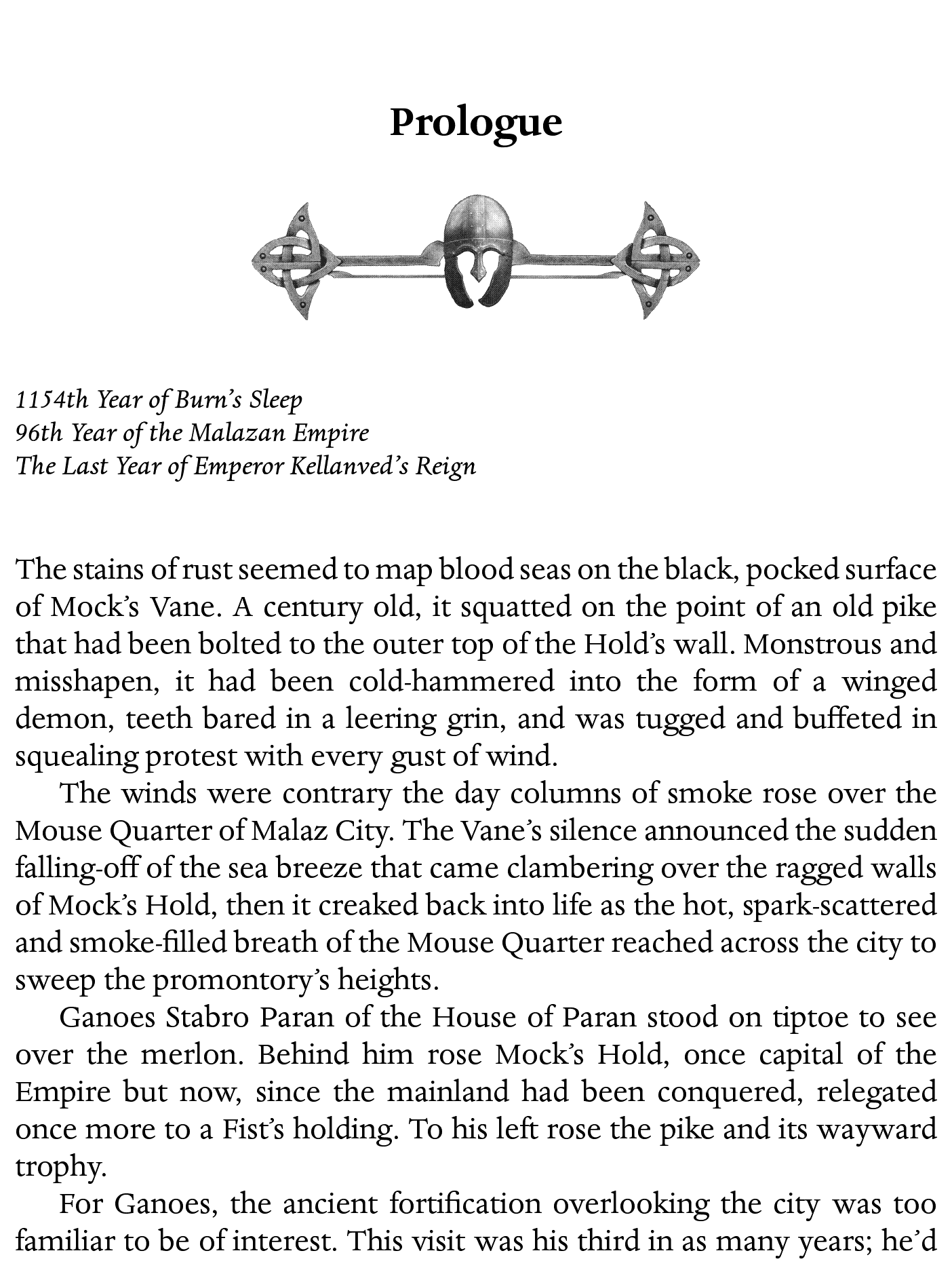

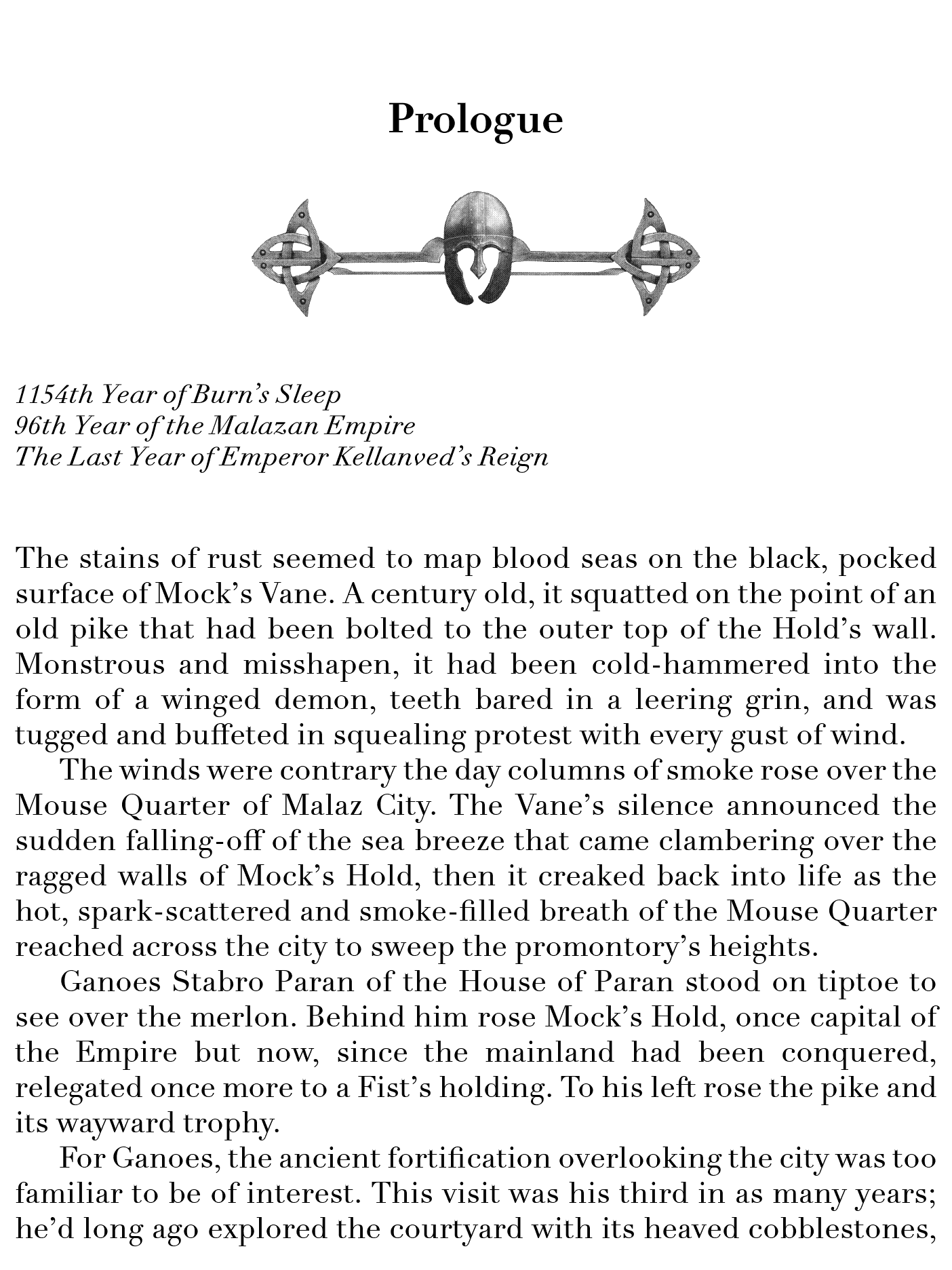

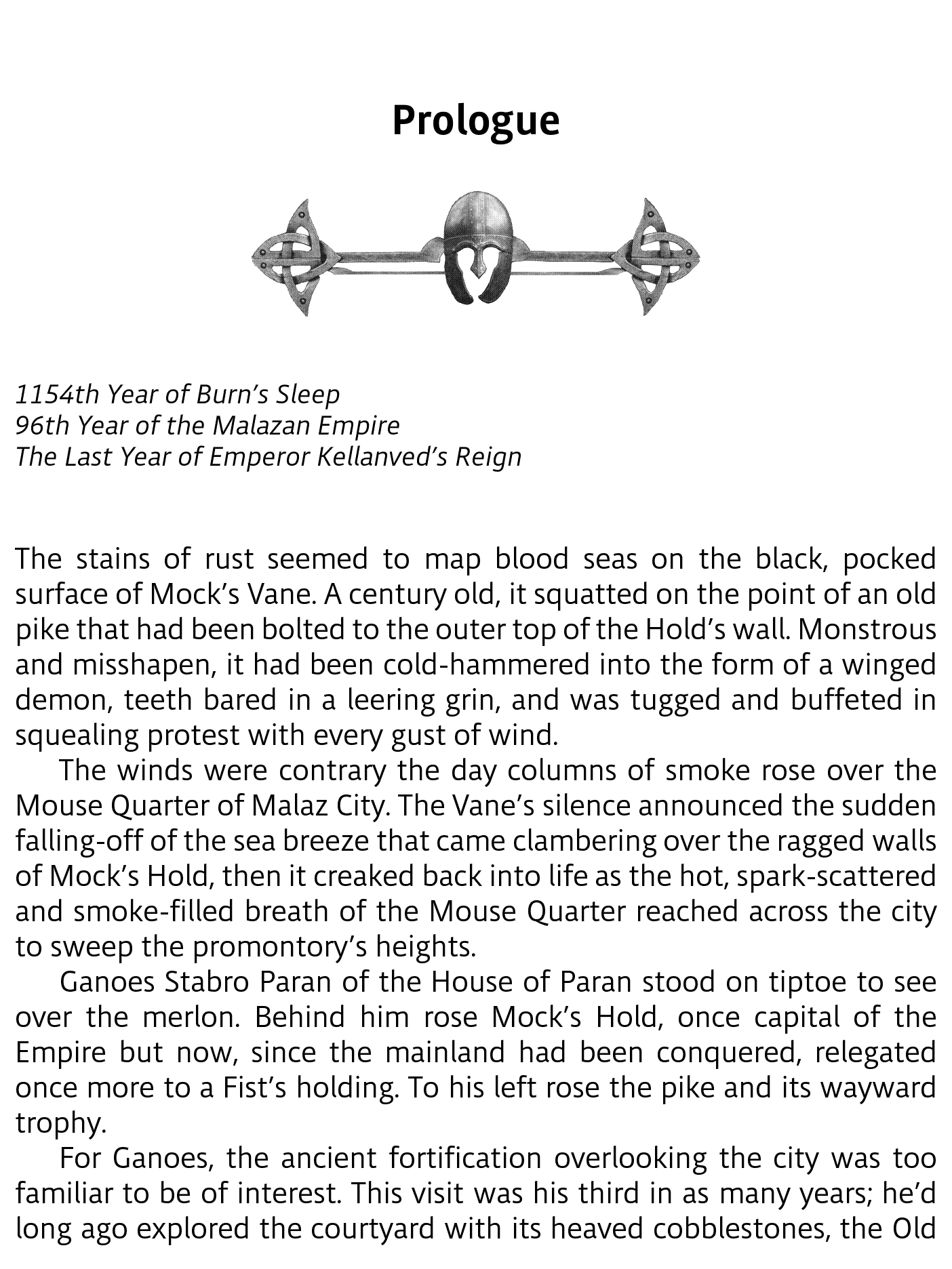

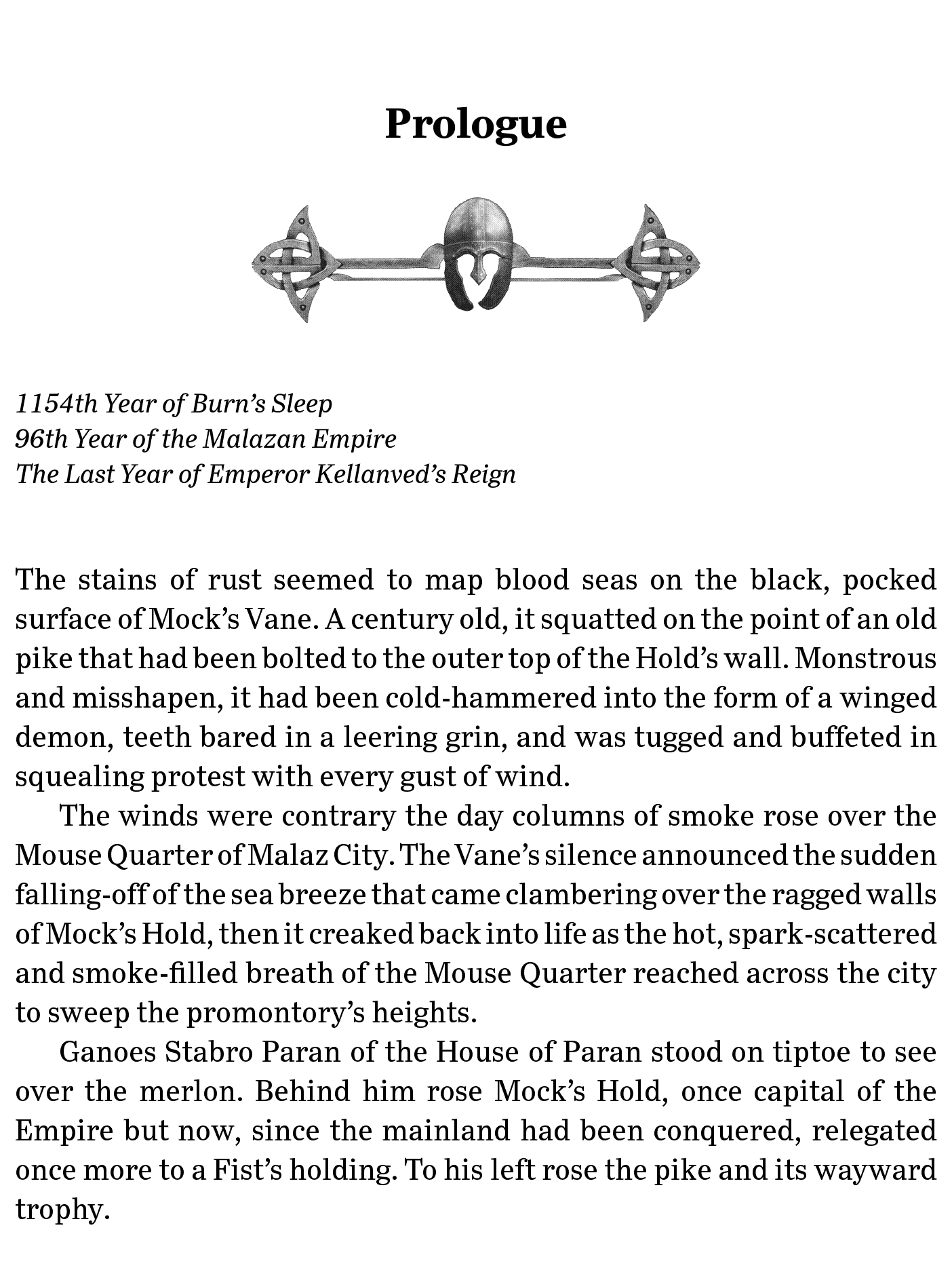

As an aside, I've included screenshots of all the eText fonts I have installed. In case you were thinking of, or still considering, getting any of them, you can see if they're worth it. One thing I can say, they look substantially... more substantial on the screenshots than on the device itself. Note that there are more fonts in the pack (like Amasis, Malabar, Caecillia, etc.), but they overlap with what comes default with Kobo, and there seems to be some interference there, so I can tell you nothing about them.
ID:	173767   Click image for larger version
ID:	173768   Click image for larger version
ID:	173769   Click image for larger version
ID:	173770   Click image for larger version
ID:	173771   Click image for larger version
ID:	173772   Click image for larger version
ID:	173773   Click image for larger version
ID:	173774   Click image for larger version

Kobo has an inbuilt weight adjustment slider. Why not use that? It gives better results than doing it with FontForge.

You just need to patch your Kobo to enable the Advanced Font Control for allowing side loaded TTF fonts to have the weight adjusted. Then you can test for yourself which you like better.
But the issue with doing it with Fontforge is that you may have to keep going back and forth to get it the way you want. With the Kobo way, it's just a slider that shows you as you change the slider.
