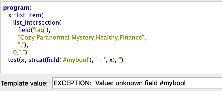

Yes, it sounds like you are understanding what I'm after, but I just tried your suggestion, and unfortunately, it didn't work for me... This is what the template tester said was wrong:
EXCEPTION: Value: unknown field #mybool

those were placeholder names for custom field TYPES
change the #mybool to the name of your Boolean field's (Y/N) name
This is correct. I didn't have a column #read_status so I used #mybool instead to test it.

Ah, I see... worked perfectly once I changed it to my '#read_status'. Thanks so much for your help!
