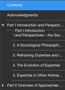

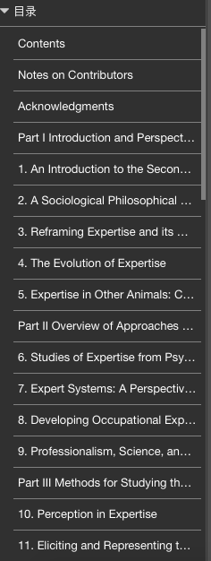

When i use calibre to convert an epub book to mobi,its TOC changed.TOC lost its hierarchical relationship.
TOC in both format is showned in attach files.
Can someone help me with this? I want the TOC in mobi is same in epub wich can be folded.

Name:	屏幕快照 2019-11-18 下午4.45.48.png
ID:	174997   Click image for larger version
Name:	屏幕快照 2019-11-18 下午4.50.40.png
My knowledge is limited, but I suspect this is a limitation of the mobi format. If you convert the book to azw3 I think you will find the TOC as you expect it to be. This section of the FAQ talks a little about mobi TOCs.

This was the answer I was thinking of (but did not reply, because I was not Positive).
I side-load AZW3. You may be stuck, if you must use email
Old 11-18-2019, 11:54 AM   #4
Posts: 81,213
Karma: 150263711
Convert to KF8 and side load. If you email Mobi, forget it.
