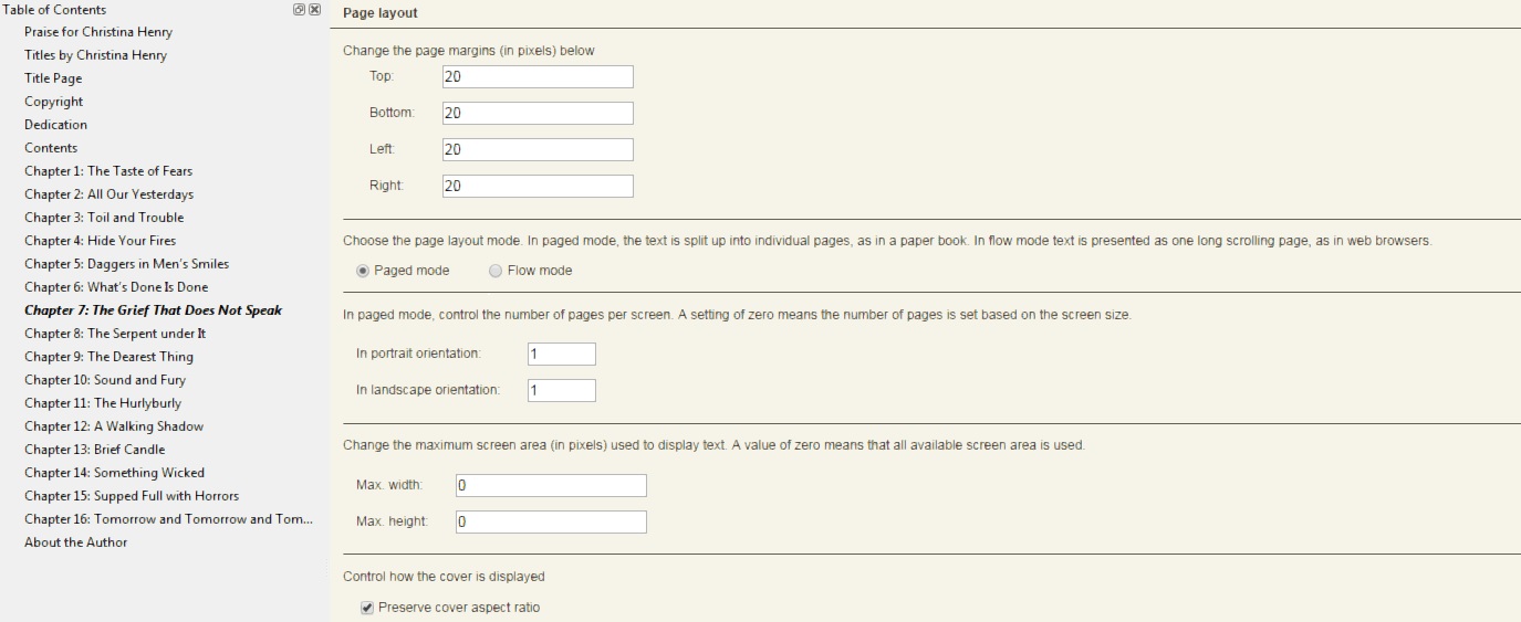

Hello,
I installed the new Calibre 4.0 and noticed that the settings and the text in the e-book are all blurry now in the new reader. See the image in the attachment.
Do you have any idea how to solve this issue?

Try choosing a different font. What OS is this on?
It's Windows 7, latest build. Choosing other fonts and/or changing font size doesn't help. The main program is crispy sharp as before. It's just the new viewer that somehow changes distorts the clear text.
And are there DPI/Zooming/Accessibility shenanigans going on in your system?
No, nothing. Every other program (including up to Calibre 4) is running perfectly.

I just tried restoring down the table of contents window: it seems to restore the sharp text in the table of contents, but the main text remains blurry. See the attachment.
Hmm. I guess that it's kind of a font or windows scaling issue?
