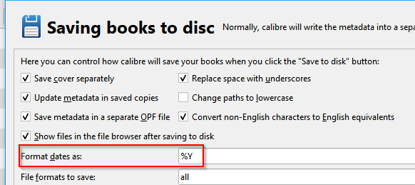

The tweek gui_pubdate_display_format only applies to GUI not to Save to disk template.
To have {pubdate:| (|) } display the date as (2019) you need to change the option "Format date as" in Saving to disc screen (see image)
