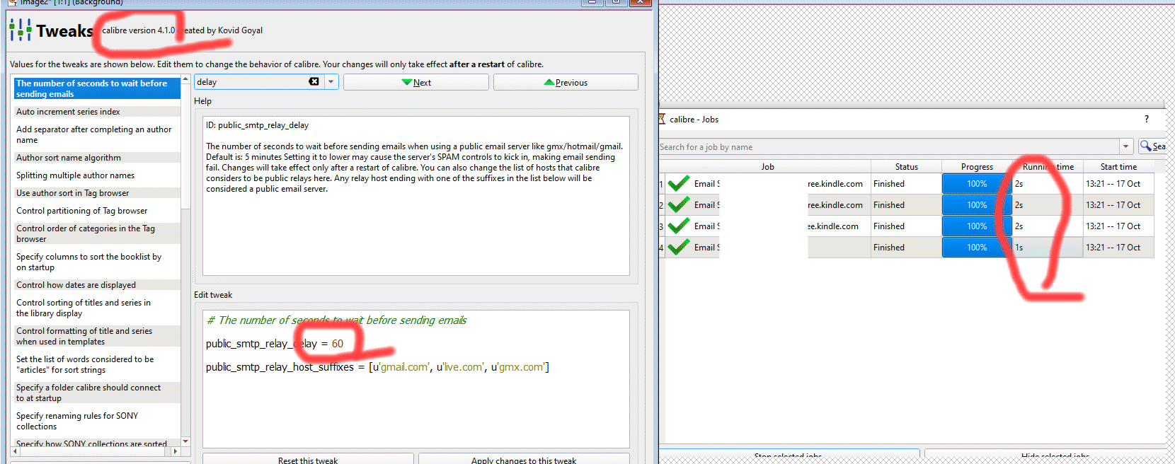

I have my mail delay set at: public_smtp_relay_delay = 60
However delay stopped working a few weeks ago and I don't seem to be getting books emailed any longer.
Something I am doing wrong?

Works for e, double click on the entries in the job log and see th edetails, there should be a line near the top that says something like "Waiting X seconds"

Starting job: Email Stealth to xxxxx (email address)
Waiting 1 seconds before sending, to avoid being marked as spam.
You can control this delay via Preferences->Tweaks
Email successfully sent
xxxxxxx@free.kindle.com

# The number of seconds to wait before sending emails
public_smtp_relay_host_suffixes = [u'gmail.com', u'live.com', u'gmx.com']
adr123 is offline   Reply With Quote
Old 10-22-2019, 11:03 PM   #5
Posts: 45,690
Karma: 28549304
Which smtp relay are you using? Does it end with one of the values in public_smtp_relay_host_suffixes
