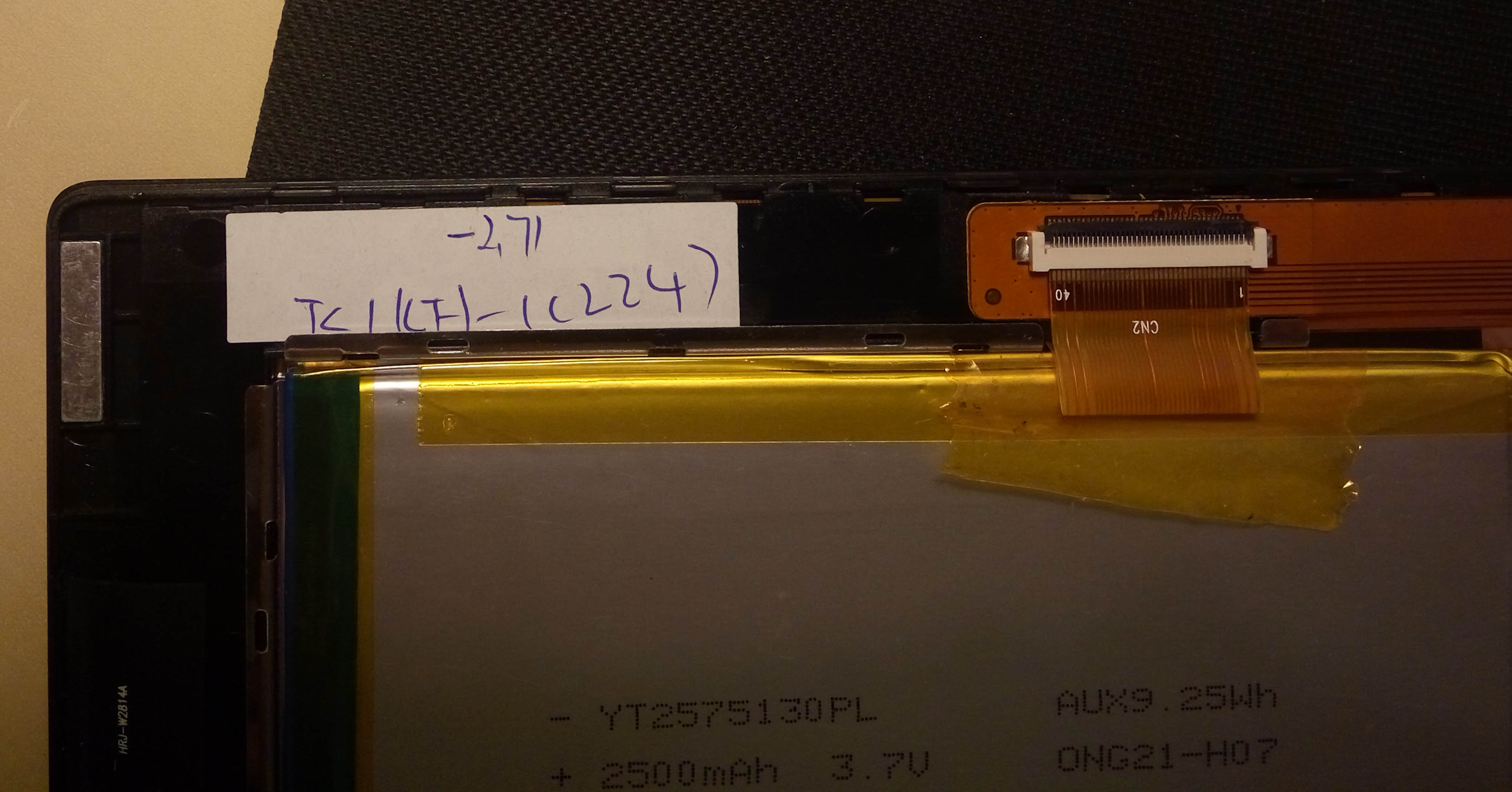

Today y removed the cover of the device and while i had it removed, the screen was working perfectly. It seems like there is a contact problem, most probably with the flex cable. I started to press it in various points to see where the problem was, and now the screen is forzen again, even with the cover removed.
Another thing that struck me is that i found a handwritten tag inside the device and something written on the motherboard, as you can see in the attached photos. I bought the device new and sealed, could it have been refurbished?

I have a similar note stuck inside mine, and I don't think it was a refurb unit. The writing looks like some kind of measured values that might be used to tune the system.
Very interesting. I was thinking of buying Inkpad 3 from the same store and seeing that tag made me doubt about their honesty. Thanks for the info rkomar.
