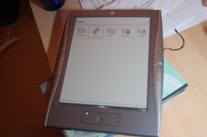

My DR1000s arrived today and it apparently has fault in capacitive sensor. I saw somewhere in the thread complaining about the same problem. This problem comes up random. You can see in the picture three sensor lights stay on. I think anyone receiving DR1000s should check the problem as well. Personally, I don't understand why iRex had to use the capacitive sensor...iLiad has more useful buttons than DR.

I got the same problem, once. As soon as I reset it they are ok.

It turns out that the problem was due to high EMI from fluorescent light!
The button problem disappeared when I turned off the light on my desk.
