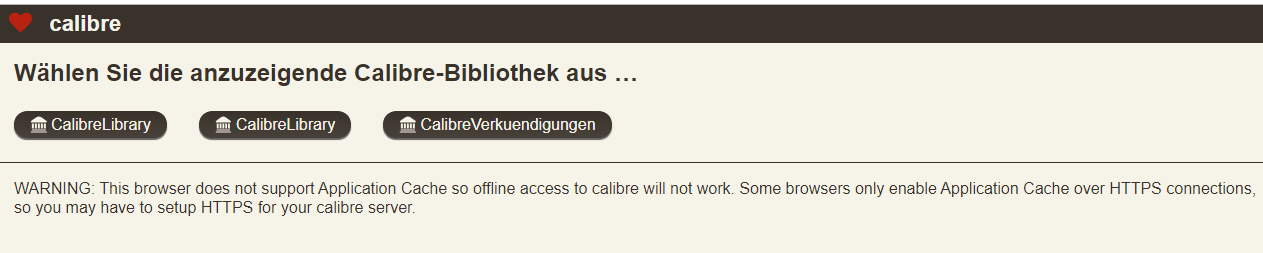

Thanks for the first replys. I guess, there are some missunderstandings.
First, if I start Calibre-GUI, create different librarys and then start the internal server, you can choose the used library after login to the web page (see attache).
I want to create this behaviour using the command line by using the calibre-server.
But the calibre-server cli didn't use the multiple librarys from command line.

The calibre-server command is documented here. You can specify a single library to use. If you do not specify a library then it will allow selection between all the libraries known by the GUI interface.

In other words: Do NOT specify the Library, then it will use all (just like the GUI)
This does assume you are running on the same system, so the config file is present that has the paths to those already discovered.
