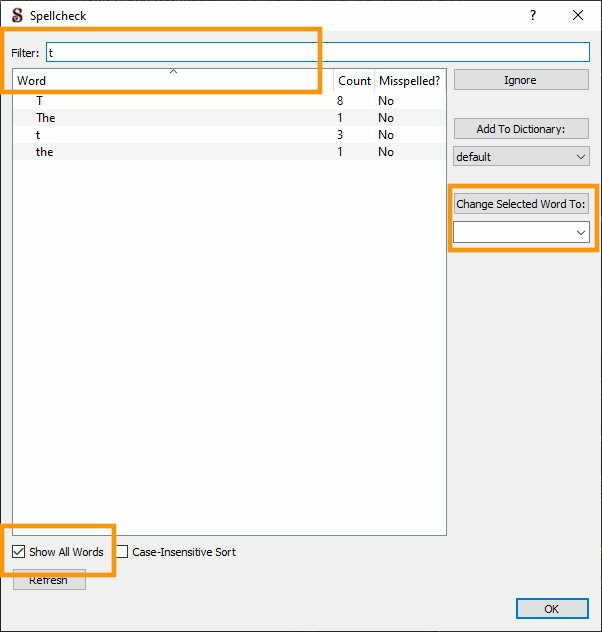

Originally Posted by neilrh View Post
Big thanks to everyone. I couldn't get spellcheck to pick up the single T, the only way I could get it to work was by showing all words and then scrolling down until I found it.
Ahh yes, forgot that "Show All Words" needs to be checked.
Here is how mine looks:
1. Check the box for "Show All Words".
2. Type T into the search box.
3. Click the word you want to replace. In this case, the capital letter 'T'.
4. In the "Change Selected Word To" box, type what you want to replace. In this case, 'I'.
Old 09-13-2019, 12:32 AM   #12
Posts: 31,341
Karma: 62025226
That is why I did not see it. I almost never tick that box (my list is usually pretty long, since I use it on SF/Fantasy a lot)
