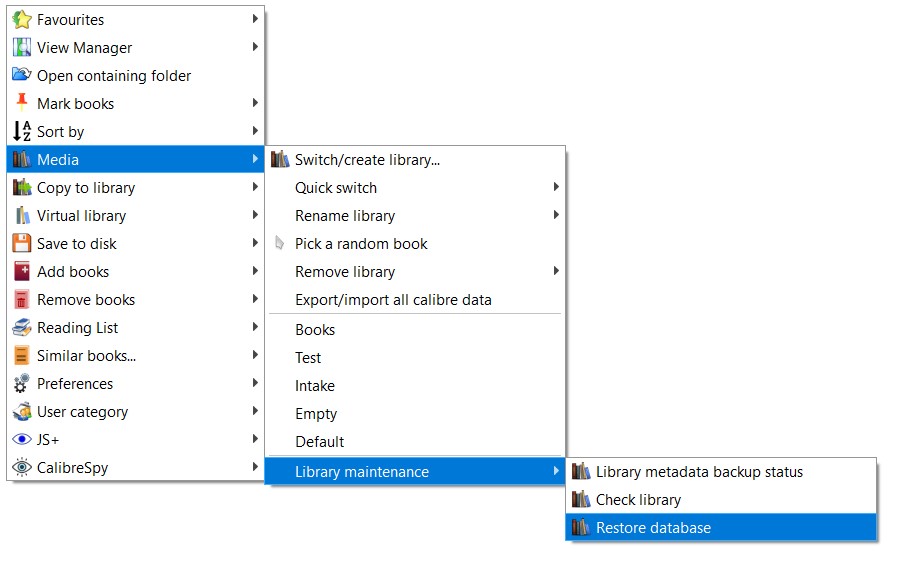

I you have a recent backup, why not just restore it.
Otherwise, I suggest you backup what you have, and then do a Restore database:
Name:	Annotation 2019-06-05 173831.jpg
And if that works, take another backup.

Then take the 'backup, Restore database' route - the first backup is just in case the Restore screws something up - it won't of course, but something else might.

Thanks BR. Have restored finally.
